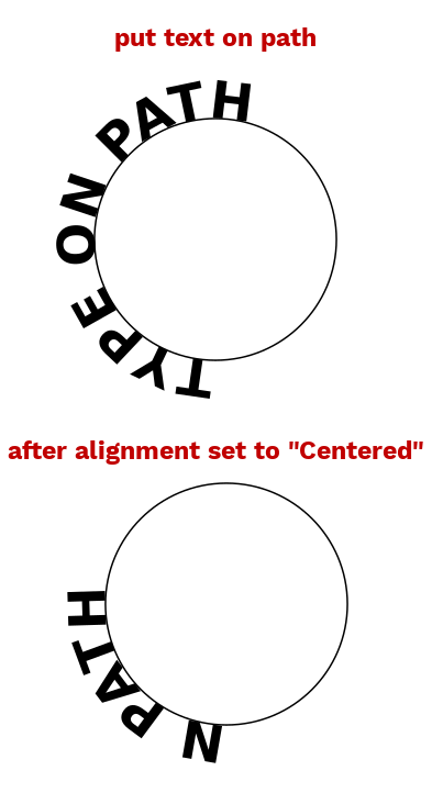

It seems the text on path behaviour has changed in the new version.
I used to split the lower node of my circle and set the text alignment to "centered" to get perfectly aligned text on a cicular path.
Doing this with V 0.92.1 doesnt work anymore. When i align the text to centered, half of it vanishes.
It only works with alignment set to left.
Apparently this new behaviour expects me to align text by rotating the path only.
Is this a bug or is there a hidden logic behind that ?

Yes, that does look like new behavior to me. What I recall, is that the text always started at the left node of the circle. Now it appears to start at the right node, which means it's underneath the circle. It can be fixed by rotating the circle until the text is where you want.
Indeed, I would guess that's a bug, where half the text disappears when you set it to centered! I'll search LP....

Couldn't find a difference between 0.91 and 0.92.1 (just tested).
But I found out that if you do the centering first, it will work (in both versions) - but it won't if you put the text on the path and center it later, then the text is cut off (or, if you right-align, it's gone).

I can confirm Moini's observations: it works when you align before putting on path.
So what exactly is the strange behaviour i have encountered ?

Source: Inkscape manual(...) If the text is center justified prior to being put on a path, it will centered along the path.
Re: Text on path, new behaviour
What Inkscape does when it puts text which is formatted as 'center aligned' prior to being put on path is to position the text (its anchor) at a 50% offset along the path (see SVG spec). You can verify that in the Text and Font dialog (it has a GUI since Inkscape 0.91 to adjust the offset of the text anchor along the path). In my understanding this is a convenience feature (in the past (Inkscape <= 0.48), Inkscape had no specific GUI element to define the offset of the text position (the anchor of the text) along the path - it could always be adjusted in the XML Editor though).
If the text alignment is changed after the text has been put on path already, this changes the position of the text anchor relative to the text, but does not affect the offset of the position of the anchor along the path (the two are independent).

There's a minor update flaw with that GUI option in the Text and Font dialog: if a text put on path does not explicitly define the 'startOffset' attribute (it then has the initial value of 0 per SVG spec), the value shown in the option field is not updated as expected (i.e. the entry may still show the (explicit) offset of an earlier selected text).~suv wrote:You can verify that in the Text and Font dialog (it has a GUI since Inkscape 0.91 to adjust the offset of the text anchor along the path).
Since work on “GUI for startOffset attribute of text path” was not fully finished so far (bug #171033 is not closed yet), this can be considered a minor glitch, I think (but I'll file a report about that detail myself).

I find that the requirement to set the alignment first is a usability issue (or expressed plainly, a documented and thus cemented bug) - it's not easy to understand for a user who just wants to change the alignment why it cuts off the text.

I don't understand - a GUI option already exists in the 'Text and Font' dialog to adjust the offset of the position of the text anchor along the path numerically [1].Moini wrote:Would the interactive adjustment of the offset then qualify as a feature request?
A on-canvas method to adjust the offset is part of the request filed in the mentioned bug #171033:
This report is not closed yet. What other feature do you have in mind for "interactive adjustment" of the offset of the text position (the anchor of the text) along the path, apart from a numeric entry widget (exists), and an on-canvas method (not implemented, tracked in bug #171033)?An on-canvas interface, dragging the text along a line would be cute, (…)
[1] ... except in current unstable trunk - see bug #1619557 for that with a new patch pending review to restore the visibility of the 'Text path offset' widget.

Text alignment and startOffset are independent attributes/features which affect the layout of a text put on path. If you want to forecfully link the two in all cases all the time, you deny users the ability e.g. to left-align or right-align text to an arbitrary (or centered at 50%) offset of the text position along the path.Moini wrote:It's not easy to understand for a user who just wants to change the alignment why it cuts off the text.
~suv wrote:Text alignment and startOffset are independent attributes/features which affect the layout of a text put on path. If you want to forecfully link the two in all cases all the time, you deny users the ability e.g. to left-align or right-align text to an arbitrary (or centered at 50%) offset of the text position along the path.Moini wrote:It's not easy to understand for a user who just wants to change the alignment why it cuts off the text.
Or explained differently: Adjusting the text alignment before putting the text on a path gives the user access to three common presets of the layout of a text put-on-path:
- Left-aligned text, position of the text anchor at the start of the path (0% offset)
- Center-aligned text, position of the text anchor at the middle of the path (50% offset)
- Right-aligned text, position of the text anchor at the end of the path (100%)

Yes, I understand, su_v, thank you!
It would just be nice if 'the obvious and standard' would be easier to access than the 'extra super-duper'.
The implementation that sets the anchor to the middle when the text has been centered first is an additional convenience, from a developer view, but it looks half-hearted from a user view.
If I click on 'center align' or 'right align' when the text is on a path and there is no offset, I don't mean to cut the text in half or to make it vanish. Aside from animation, there is no sane use case for this, as far as I can imagine. Detecting the opposite (e.g. un-center when it's centered) is a lot harder... Would be just guessing...
I have no idea how that would need to be implemented, or what the GUI would need to look like, though... sorry about that. It's tricky.
Maybe there's a way to give a message in the status bar, hinting at where to make the setting, whenever the text is cut off?
