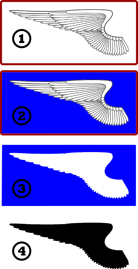

I apologize if I was unclear. Basically what I want to do is fill in the shape below entirely with black so you can just see the outermost outline.

for this particular problem I would not use use trace bitmap.
1. with the bitmap in inkscape draw a rectangle (actually any shape will work) around it completely enclosing it with no fill and a stroke, making sure that there is a nice distance in between.
2. Using the bucket tool and appropriate settings in the control bar click in the area between the drawing and the outer stroke.
3. If you get a stroked object just swap fill and stroke .. either now or later... Note that the bucket is more accurate at higher zooms. In the interest of full disclosure , I actually zoomed pretty far in and clicked five times with the bucket and unioned the shapes. 4. Break the resulting shape apart and delete the outer path of the two. I then did a simplify to reduce the number of nodes. Then some node editing was done, but not absolutely necessary.
I've attached the result for comparison's sake...

Thank you so much Druban!! Exactly what I needed!!

Oh wow, that's awesome druban!
I never would have thought to use the Paint Bucket tool on a raster image. But it works brilliantly!
