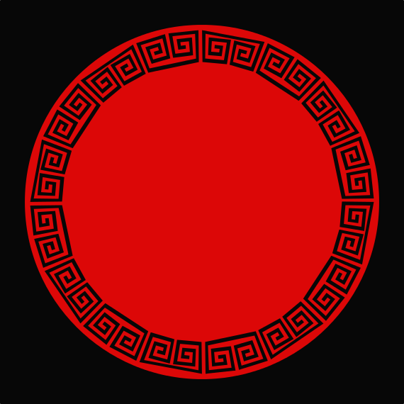

I tried to make this chinese ornament with the Pattern along Path LPE.
It works as long as i use half the pattern, but as soon as i use the double pattern, Inkscape crashes every time.
How can that be ? The pattern has only 72 nodes...
Is it a bug ? I tried the 0.92pre3 version and it crashed all the same.
Inkscape can not handle pattern along path for chinese type ornament

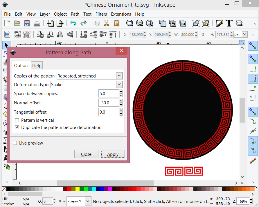

Seems ok here...
What is your system setup?
- Chinese Ornament-td.svg
- (203.09 KiB) Downloaded 168 times

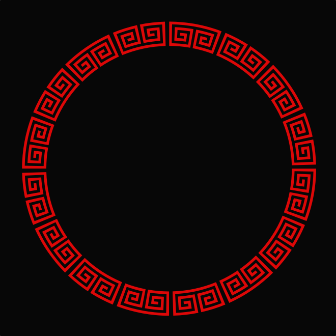

You used the extension, im talking about the LPE !
My specs are: CPU 3,9Ghz and RAM 4GB
When i first saw your result i couldnt understand why yours looks so smooth, because when i tried the extension, my patterns were all ugly, but then i realized you added more nodes !
Re: Inkscape can not handle pattern along path for chinese type ornament
^-just set path segments to curved ones and the extension will bend the pattern in nicely too without adding unnecessary nodes.
Lazur wrote:^-just set path segments to curved ones and the extension will bend the pattern in nicely too without adding unnecessary nodes.
Nice trick (!), although i have no idea why it works.
