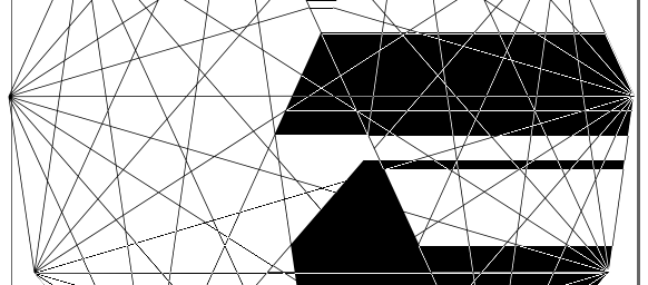

i have uploaded an image of my polygon, realized with the effect "stictch sub-paths", there is a patch or a solution for this bug?
- bug.png (45.98 KiB) Viewed 15725 times
Re: How to remove double lines?
d4rkheart wrote:i have uploaded an image of my polygon, realized with the effect "stictch sub-paths", there is a patch or a solution for this bug?
You mean the rendering glitches on-canvas with paths which have a lot of nodes? Slightly change the zoom level, or the path width (or both). Those issues are known - they appear to depend on the zoom level and are influenced e.g. by the stroke width. If the same happens when exporting to PNG (File > Export Bitmap…), try varying the DPI value in the export dialog slightly (use 89 or 88 instead of the default 90). Hopefully the new renderer (on the roadmap for 0.49) will handle such paths better.

"You mean the rendering glitches on-canvas with paths which have a lot of nodes?"
Yes, when I change the zoom level doesn't always solve the problem, and then I'm forced to change the lines' thickness. With png files i haven't problems.
I hope the 0.49 version solves these bugs.

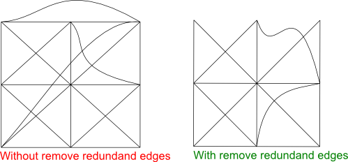

- g3029.png (25.06 KiB) Viewed 15690 times
