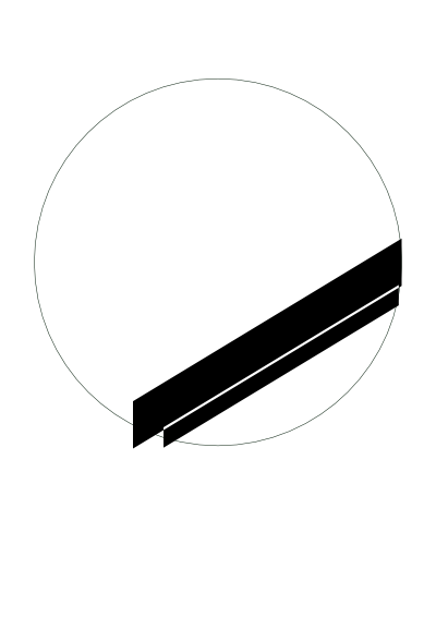

Re: Trouble using "pattern along path"
Here's the result...
- PatternPathDemo.png (14.44 KiB) Viewed 2346 times
It doesn't matter what pattern I use, or how many nodes it has, it always gets garbled. My original pattern had hundreds of nodes, and still got screwed up.

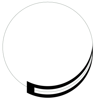

I got the exact same result you did, using the Pattern Along Path extension. But after adding nodes, as -Rob A> suggested, I got this:
Is that something like what you're trying to achieve? I used Single and Ribbon. And I ended up adding almost 1000 nodes, using the Add Nodes extension (using a setting from a previous project, out of laziness). You could probably do with half as many, actually, or even a quarter.....maybe even eighth as many....it depends on how smooth you want it. Also, be sure that the pattern is on top in z-order, before selecting it.
Since I don't understand your ultimate goal, I don't know if the above is close. But you can see that I used the circle as the path. If you're going for something like a logo (or planet effect) where you need the pattern symmetrical, you'll need to rotate the circle....by 22.5 degrees, I think. I could be wrong about the degrees.

I have a logo that consists of a rectangle with some text inside. The text is not actually in the form of Inkscape-recognised text, but just "cut out" of the rectangle. I want to bend it so that the lower edge of the rectangle follows the curve of the circle. (Up to a rotation is fine, it's easy enough to make things symmetrical.)
