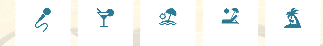

Hello. I have a question about using Inkscape. I have some png icon. I created a vector images from this icons and save it as plain svg. Then I use this svgs on webpage. For each svg I set height as 90px. But real size of each icon was different as you can see on attached image
As I understand, each svg was saved not by size of image, but size of white canvas in Inkscape.
I'll be grateful, if somebody explane me, where I did a mistake.

You can set the size of the canvas via File > Document Properties, in the "Custom Size" section. You may then need to move or scale your images to fit the canvas area before you save the file again.
