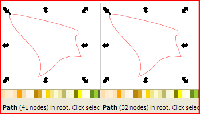

monast wrote:The difference is a path stores the starting point and lists the relative positions of the following points... This problem has impact on things like rotation if you haven't noticed yet.
I am not sure if this will help you, but Inkscape has a preference checkbox for "allow relative coordinates". it's under SVG output. To get the program to rewrite all the path data you will have to move the path (move it back afterwards and it will write it again...). I use arrow up and arrow down, but in your case there maybe a long wait in between. I am nor sure how the preference works; to be absolutely sure I would uncheck this box, close Inkscape and then reopen it. Usually the prefs that need a restart of the program say so, but it seems an okay precaution to take.
Please note that your paths cannot be in a group or Inkscape will create a transform attribute for the group instead. Ungroup all groups if your work will allow it.
About the extra nodes - while the simplify command will change the path shape and is not appropriate for precision work, the union operation will get rid of overlapping nodes with no change to the path. (This is a one-shot operation; repeating will have absolutely no benefit). Be aware it will join overlapping paths. if all your objects are separated from each other this will not affect you. Try it on a few selected objects first to see what improvement you get, if any. In fact it will work on a single object so you can see (from the info bar if you are in selector tool mode) exactly how many nodes have been eliminated.
Caution:unclosed paths that don't touch another path will be left untouched if they are a straight line segment and will be closed if they are any other open shape. Line segments that intersect will disappear so if you have any objects that are made up of unconnected line segments they need to be joined first.
- Before and after Union operation
- rect4037.png (8.42 KiB) Viewed 7436 times
