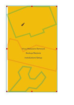

Here is a screen shot of the vector in Scribus. The problem object is the black screwdriver icon.
The icon does not show up in the svg file.

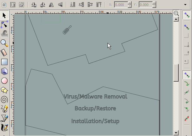

Try Looking using Menu: View> Display Mode >Outline

Re: Foreign object in my SVG import
Hard to say... it is a clipped object, so not visible without removing the clip or viewing outlines.
