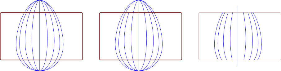

I ran into the cut path bug today and went to upload the file to lanchpad. The cut path lost some segments, but it also would not cut other segments. I uploaded the SVG to lanchpad, and I notice that only 2/3s of the svg is displayed in firefox. So I also uploaded it to petaimg. With the same results. IE just tries to down load the image not display it. (There is probably a setting to change, but I have used IE in to long...) Why is the first third of the image not showing displaying. I redown loaded the file form lanchpad and it's all there.
Bug report page.
https://bugs.launchpad.net/inkscape/+bug/166302
Image at petaimg
http://www.petaimg.com/uploads/1237336957.svg
Three views One, before the cut. Two after the cut. Three with the line segments completely out side the box deleted.
PNG of the full image, the part before the cut is not displaying for me in the SVG format.
Quirk in Cut Path Operation and SVG Dispaly in FF

If I understand your message, there are 2 problems -- a bug with Inkscape's Cut Path, and a problem with how your sample images are being displayed after you upload to hosts?

Re: Quirk in Cut Path Operation and SVG Dispaly in FF
If you turn on your page border in Inkscape you'll see that the first image is outside of the page, that's why you don't see it in any SVG viewers.
Oh, and I can't explain why those lines behave oddly. Without examining the XML (which I wouldn't understand anyway) I question if those lines have an error in the way they are described. Note you can refine that example by breaking apart the egg and deleting all lines bar the dodgy ones--they behave badly on their own as a single line. I see that you had described how you created the lines on Launchpad, which is probably what the developers will be most interested in.
microUgly wrote:If you turn on your page border in Inkscape you'll see that the first image is outside of the page, that's why you don't see it in any SVG viewers.
Oh, I did not know that, FF just displayed the page.
microUgly wrote:Oh, and I can't explain why those lines behave oddly. Without examining the XML (which I wouldn't understand anyway) I question if those lines have an error in the way they are described. Note you can refine that example by breaking apart the egg and deleting all lines bar the dodgy ones--they behave badly on their own as a single line. I see that you had described how you created the lines on Launchpad, which is probably what the developers will be most interested in.
You don't know XML! I'm shattered. I don't don't really understand it either, but I'm shattered anyways. J/K I was mainly interested in why that part of the image wasn't dispalying. Now I can the page to drawing fix the uploaded image. At least I think you can re-upload anyways.
