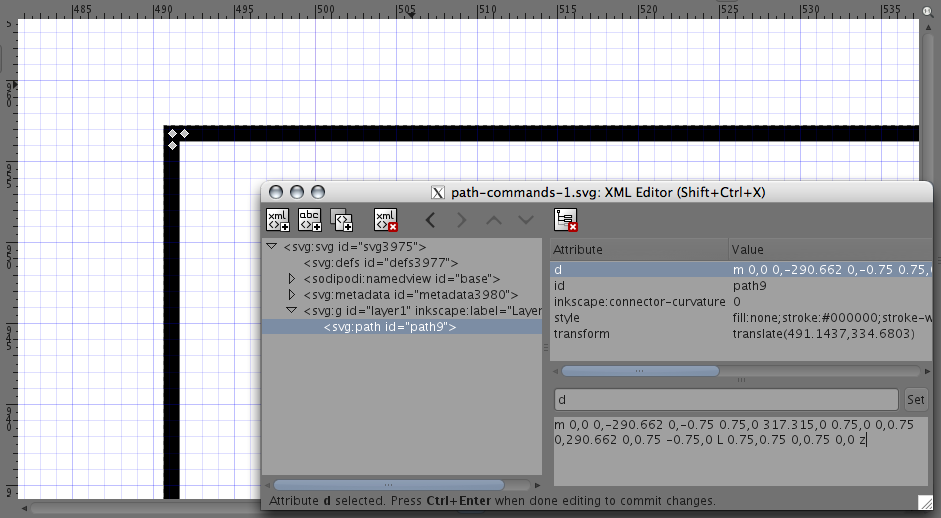

AFAIU this is not true - Inkscape (as well as any other SVG renderer I tested) does correctly interpret the omitted commands as lineto, not as moveto - tested in Inkscape (stable and trunk, with default preferences) by replacing the 'd' data of an existing path (copy&paste), as well as by comparing the resulting path data created by drawing a rectangle in Inkscape and converting it to a path.
See also the SVG specification detail for the moveto command
If a moveto is followed by multiple pairs of coordinates, the subsequent pairs are treated as implicit lineto commands. (…)
See also the attached a screenshot zoomed in into one corner of the rectangle (which has three nodes at each corner), showing the nodes within the node tool context (the document size is 1000px x 1000px, the 'transform' attribute was applied directly to the path instead of the parent group or layer):
- path-commands-corner-screenshot-2.png (64.79 KiB) Viewed 3663 times
