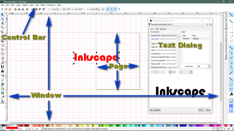

inkscape has a window sometimes called the drawing board, at the center of which is a page and at the top of which is a control bar that contains settings and controls appropriate to the currently chosen tool.
- 2018-11-16_010659.png (221.56 KiB) Viewed 2175 times
Re: Text: Editing slowness
What is labelled as 'Window' in druban's screenshot is what is generally called the canvas. The window is the whole screenshot, the canvas is the area where you can draw.
The 'Control bar' is the 'Tool controls bar', btw.

For more information on the Inkscape interface: http://tavmjong.free.fr/INKSCAPE/MANUAL ... atomy.html
The Command Bar can also be located above the Tools Controls (default layout).
