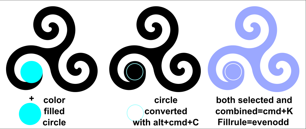

Re: How to cut with specific shape (circle and ring)
Let´s see if this helps:
Ungroup everything - You have to add the black circle first with the triskel, Convert the white thin circle to a compound path and combine it with triskel.
- forum_reply4U.svg
- (44.02 KiB) Downloaded 282 times
