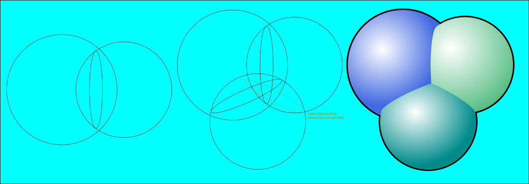

SO here is a little diagram of a simple way to do this, using the Boolean functions division and union to cut away the unneeded parts of three circles to simulate a 3D render.
Oops the text that says "Cheating Ellipse! Should be a straight line" is too small to read. Basically it means that correctly the join between the two same size spheres should look like a straight line but a curve is visually more interesting so I made a shallow curve that is not too far from true.

Nice diagram!
Just a note, even if it's for "eyeballing" an acceptable look.
The cutline of the two spheres being an ellipse, right.
Cutline is the same as if the spheres were split into two pieces by a plane.
Now, let's look at the sphere on the left alone with that cutline=circle and ellipse. You couldn't give those a fill for a shaded look as they don't make much sense in 3D.
The ellipse positioned in the depicted way would definitely be tangent to that circle as well.
Not saying constructing the accurate image would be easy though. Probably that would be more error prone than simple eyeballing.

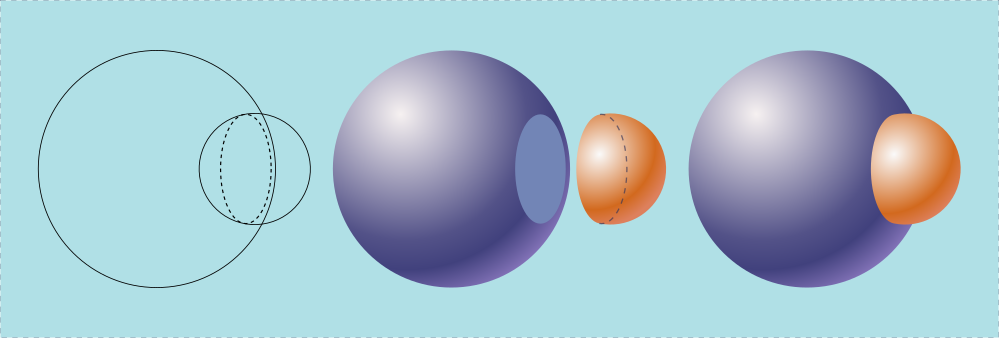

Almost all the time you are dead on, Lazur, and probably this time too! But I don't understand what you mean about the gradient fill... Inasmuch as a radial gradient can approximate a highlight on a sphere for inaccurate but convincing illustrations I don't see the problem with any of these fills - I know the real highlight would not be circular but curved, of course.
As for the tangency thing I kind of thought that too when starting out but realized it's only true for spheres of the same size or when the plane of intersection is parallel to the line of sight. And also not considering perspective which adds some more complications.
I will try to do an extreme case illustration when I have time if I have expressed this badly...

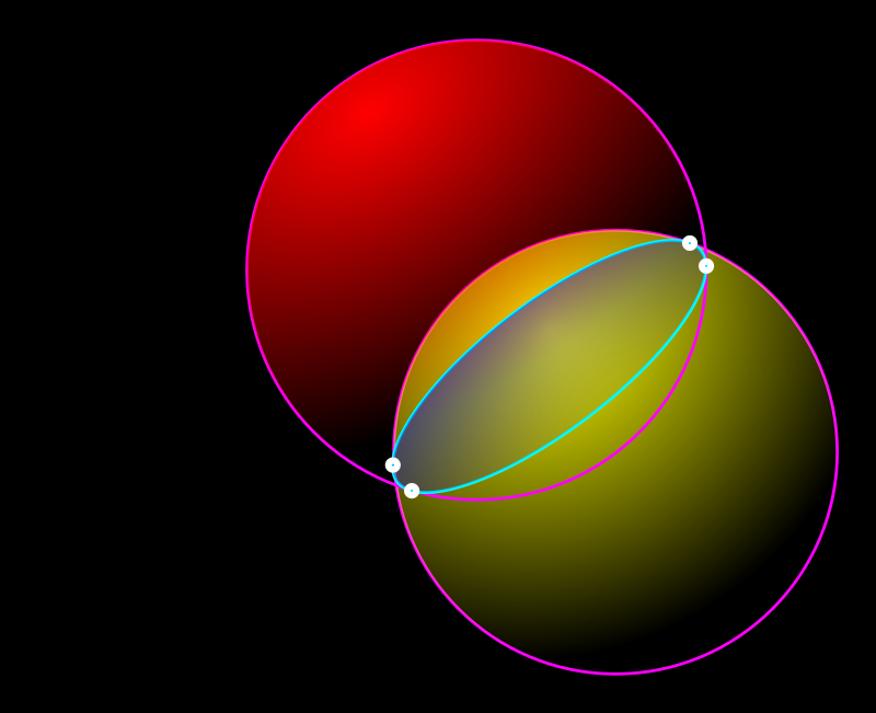

Thank you but I might have jumped too soon this time.
The cut line-ellipse can be non-tangent to the sphere/circle as well.
With such a height/width ratio on the ellipse I'd expected a view from a narrower angle, which would result in tangents.

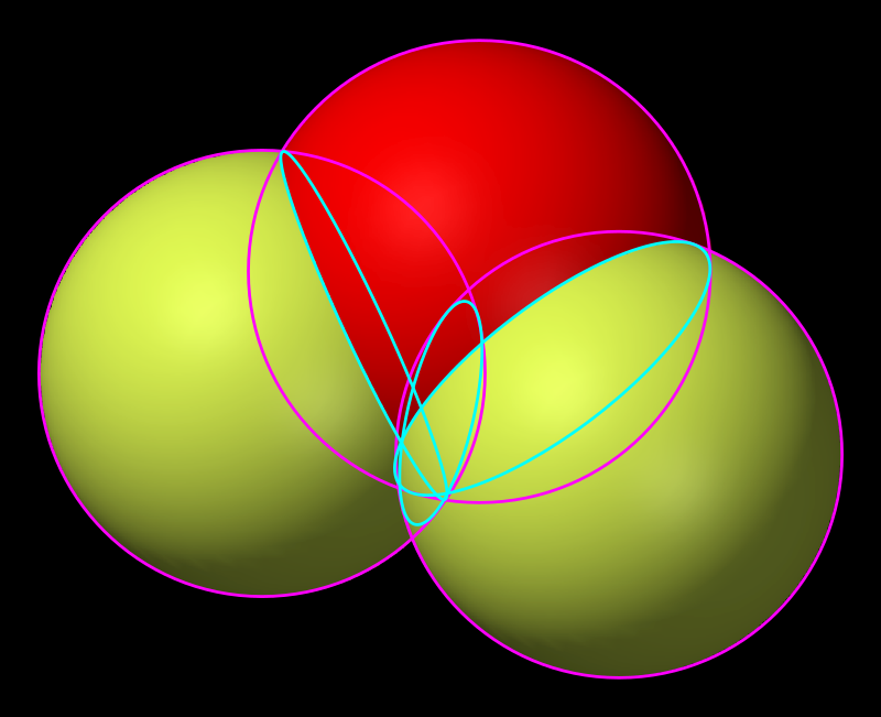

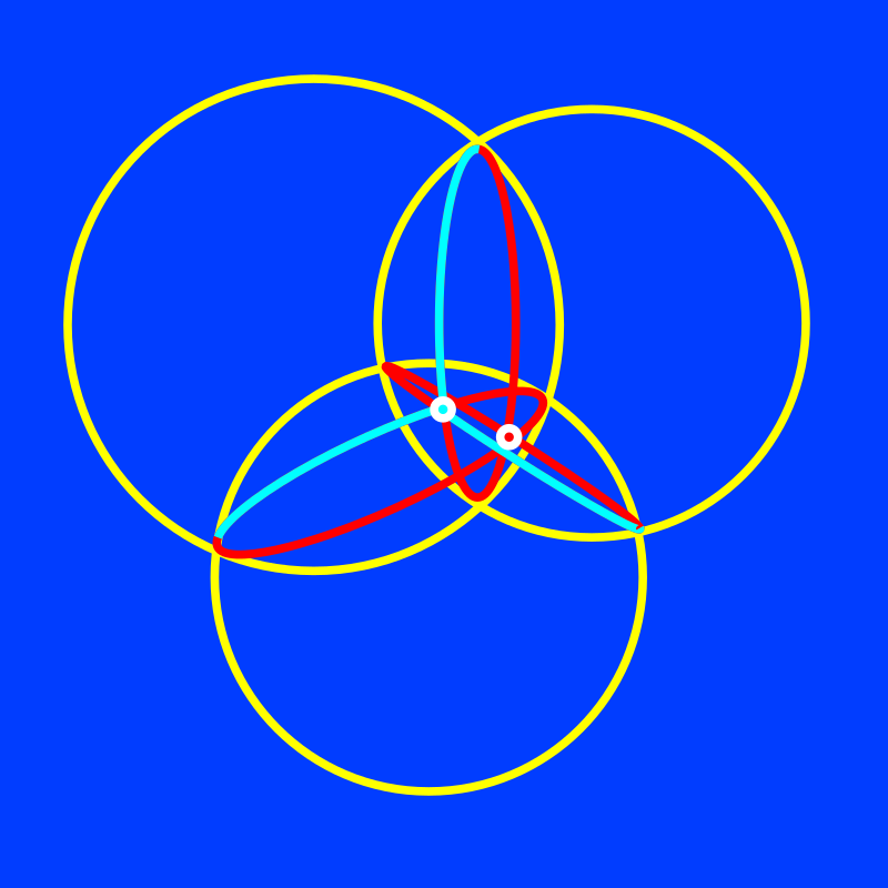

Another note.
If the three cutlines intersect in one point at the front, they are intersecting at the back in one point as well.
Three cutlines intersecting:=three planes can be layed on each cutline, which are intersecting;
Two planes intersecting have a line as a cutline, these three cutlines of the spheres therefore define an axis. Which axis cuts the sphere at two points. One in the front, one at the other side.
