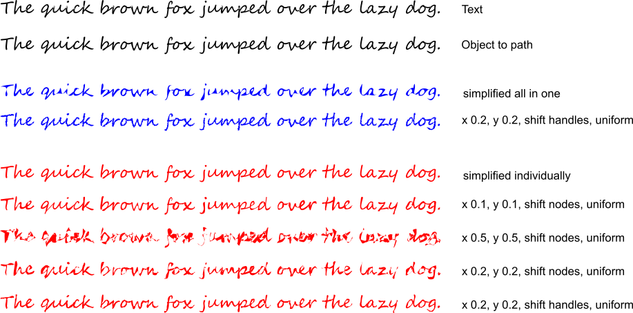

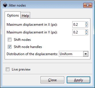

Maybe you can try the Extension | Modify Path | Jitter nodes...
I tried with the font "Segoe Script, 12pt" because it looked almost like a handwriting.
Type your text and do "Object to path".
In this example each letter will now have about 40-80 nodes. However, if you jitter these nodes it looks like noise.
So I tried to reduce the nodes (simplify Ctrl+L). Then you have about 10-25 nodes in a letter. Apparently, it makes a difference if you simplify all text in on go or for each letter individually. I don't know why. I would have expected the same result.
You can play with the jitter parameters... I don't know if there is a good parameter set which mimics variations as in "real" handwriting.
Let us know if you found a good parameter set or a better solution.

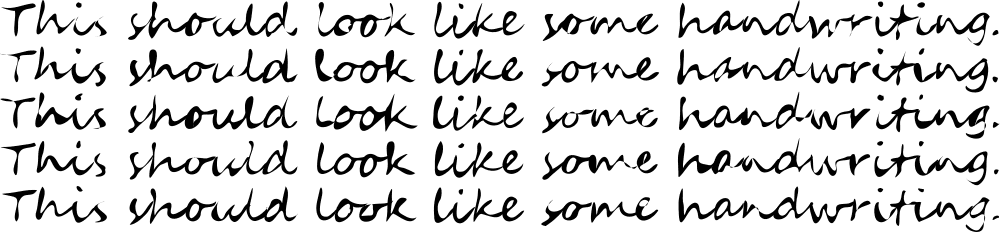

Yes, @tylerdurden, the LPE "Roughen" seems to be much faster and more flexible than the extension "jitter nodes".
The following result I got with adding additionally the LPE "Simplify" after LPE "Roughen" and playing with the parameters. You can see the random variation but handwriting variations are still somehow different...
