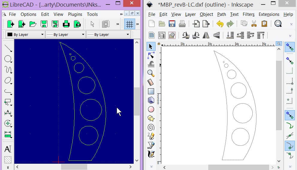

The example file is still online and still has an issue opening in Inkscape, due to AutoCad version.
The dxf can be opened in LibreCad, saved as dxf version 2007, then opened in Inkscape.
