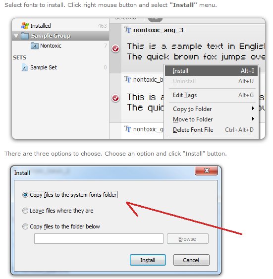

I would try using a font-manager's option to copy files to system fonts folder...
e.g. NexusFont:
(scroll or click to expand image, germane info in lower half)
I also have thousands of fonts, organized in folders. I only keep about a few hundred copied into the system folder at any given time. I use a font viewer to browse styles in the archives and simply copy/install the desired fonts to system when needed.
e.g. NexusFont:

tylerdurden wrote:I would try using a font-manager's option to copy files to system fonts folder...
e.g. NexusFont:
Your comprehensive and helpful post finally spurred me to alter my font setup. Rather than using MainType to install -- that just adds a shortcut into the Windows font folder pointing at the actual font file -- I've switched to NexusFont for any font install/uninstall.
I had previously thought of having the font manager actually copy the font files into the Windows font folder, but MainType doesn't have that option. Despite having NexusFont installed, I'd never used it in anger to install/uninstall so had missed the fact it had the copy option (thanks!). I'll relegate MainType (it's not straightforward with that to find where the physical font files reside anyway) and use NexusFont to do the installs.
Given that any fixes to Inkscape are unlikely to be rapid, this is definitely the path of least resistance.
Thanks again - OldClicker
