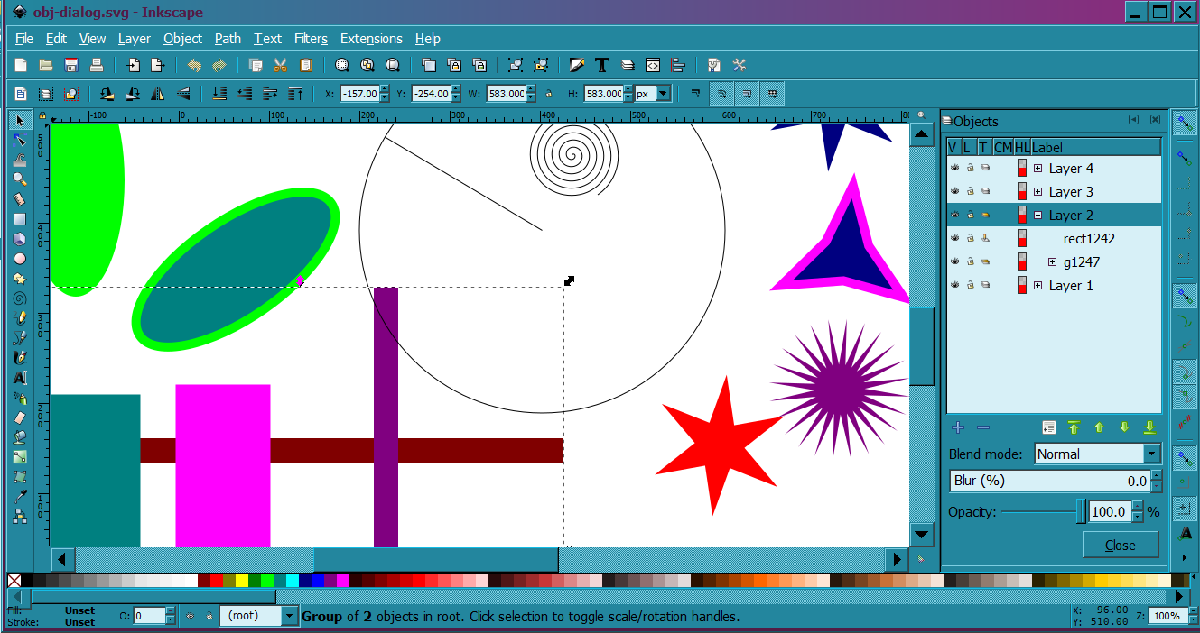

It says it in the status bar, when it's selected. Attached screenshot.
It still indicates Layer 2 in the dialog, although I can understand why it takes the name of the former layer. But the status bar says the new group is in the root layer. Can't move it up because it says there are no more layers above. But you can see there are still 2 layers above.
"above" and "around"?? Is there such a thing as moving an object "around" a layer?
- obj-dialog.svg
- (13.14 KiB) Downloaded 150 times
- obj-dialog1.png (136.86 KiB) Viewed 3722 times
Re: Object Manager Mysteries
That's because it *is* in the root layer. You have selected 'Layer2', after having it converted to a group.

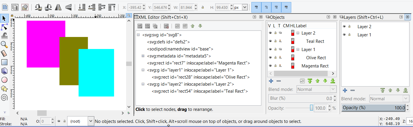

It depends how you want to move items "UP".
"Root" contains all objects and layers/groups (similar to <body> in HTML). Therefore, all layers are sub-layers of root. An object can't be moved UP into a sublayer from its parent using the Layers menu.
In the attached image below, the magenta rectangle in root can't be moved into Layer1 or Layer2 with the layers menu because it's in their parent, at the bottom of the z-order.
The magenta rectangle can be moved in its Z-order above the layers, using the stacking buttons (controls bar) or the green arrows (Objects Dialog).
It can also be moved into the layers using Shift+PgDN (but not back into root).
- root.svg
- (2.74 KiB) Downloaded 150 times

Moini wrote:That's because it *is* in the root layer. You have selected 'Layer2', after having it converted to a group.
Of course, I know it's in the root layer. I wasn't confused about that.
I'm confused because the group can't be moved up into a layer above where it appears to be now.
I think it either needs to be shown as the top item in the z-order structure (in the Objects menu), or not go to the root layer when it's changed from a layer to a group. I mean, if that's what the Objects menu is supposed to do (or one of the things it's supposed to do), show the z-order, then something's wrong when you change a layer to a group.
If that's what the root layer is, then it ought to be displayed that way, in both Layers and Objects dialogs. As it is, the root layer is a mystery for most ordinary users.
