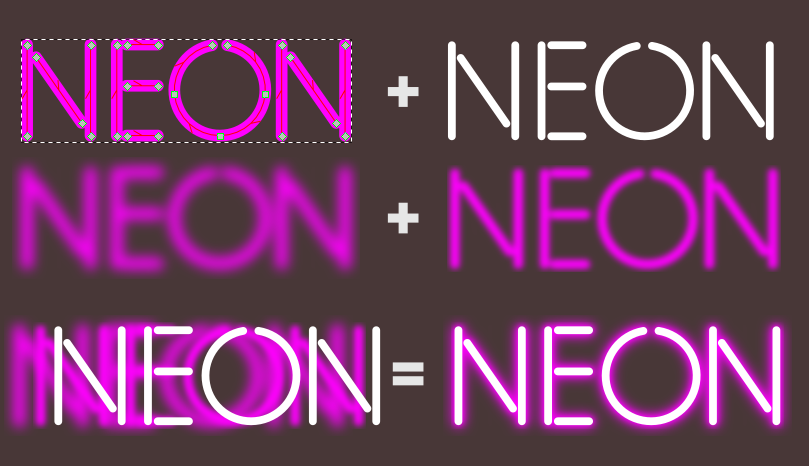

Re: Complete noob alert. Please nudge me in the right direction.
I don´t think that´s very hard to build from scratch.
Simple doubled with thicker lines and blur for the shine beneath the white objects:
Maybe there´s a font that will do already with an thickened outline blurry double underneath.
