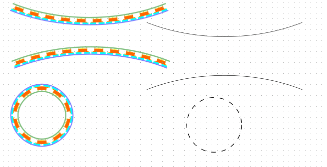

Hello,
When using path effect bend on 2 rectangle on top of each other, the resulting path is always bending downward irrespective of the fact the my arc path points upward or downward. I was expecting the bending to follow the path exactly.

Works for me - did you click on 'edit on canvas' in the path effect dialog (the node tool icon) and then manipulate the bend path?

Oh, I see. It's due to the bend path actually bein an 'arc' with a transform. Please convert to path first. Make sure to set Store transformations to 'Optimized', too, in the settings at Edit > Preferences > Behavior > Transforms.

Thank you it works. Converting the arc to a path first does the trick.

Hum, never mind. It still does not work for the picture I actually want, even though I converted everything to paths. The path object is bending the wrong way and sometimes inkscape starts crashing when I paste the arc path in the "path effect bend" dialog. I am running Inkscape 0.92 on the latest ubuntu.

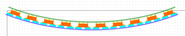

Thanks for the reply P. Except that it should be bending the other way (downward). But it only bends upward regardless of which way the copied Arc is pointing.

It will bent to whatever you like:

Please adjust your transformation settings as advised above, chaffra. After this, move your bend path once before you copy-paste it into the path effect, to trigger a path rewrite.

I don't know what I am doing wrong. How do you select all identical shapes by color&fill? I do not see the merge function. Also I made sure the preference setting is correct as suggested. I also moved the paths to force a rewrite. But it's still bending the wrong way. I tried your example on my computer and it works but I can't reproduce how you did it.
The circle bend is an interesting case that might help solve it. How does Inkscape know which way to bend the pattern in that case?

It has to do with the direction of the path. You can flip/mirror it horizontally or vertically and see how the LPE changes the output accordingly. The actual version lets you adjust the direction and scale interactively:

Ha, nice trick. It's working as I expect now. There's still the issue when I try to bend a big group of objects.
