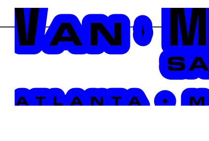

See attached photo. I am making stickers. The logo, in black, gets an outline in blue. I am using "dynamic offset" to just pull the node to balloon a duplicate (in blue) of the black logo. Other logos worked fine, this one is getting cut off at the bounding box limits, and the bounding box is not expanding with the dynamic offset expansion as it does in other logos. There must be something locked maybe? How do I get the bounding box to stop cutting off the edges?

- blue part is cut off at edges, it should balloon out all around the black letters

Hhhmm, it's hard to say for sure. Does the logo object have any clipping applied to it? If you select the text/logo (with Selection tool), look at the bottom of the window at Inskcape's status bar. It will say "Text (font, n.n px) clipped in Layer 1" or something similar. Although no, I've just done some testing, and that does not appear to be the case. The offset would not be clipped, even though it was duplicated from a clipped object.
Is the logo imported? Well no, I don't think you'd be able to apply the offset to a non-vector object. Hhhmmm.....I seem to be stumped at the moment!
Could you please attach the SVG file to a reply (or upload to the host of your choice, and give is a link)? And also, please let us know your Inskcape version and operating system?
OH! Is there perhaps a white object, sort of like a frame, around the text/logo? Or maybe a separate wide white stroke? If that's not it, I"ll have to look at the SVG.

I can't tell that there is a frame. Here is the file uploaded. It is unchanged from the earlier pic on comment.

I'm not sure how this might have happened, but it looks like you might be learning as you go? Which is not a problem, that's how I do it, lol....everyone, I guess! The reason I say that is that there are so many Groups of 1 object. I had to ungroup many, many times before I finally got down to the problem.
The blue letters to which you applied the offset had indeed been clipped. There are others here who are better at diagnosing things, so maybe one of them can determine exactly how this happened. I also found that the black letters had been clipped, and I suspect that you simply duplicated the black lettering to create the blue, and that duplicated the clipping. Which is fine, but I don't see any reason why the black letters needed any clipping.
I think that one or more of the Groups of 1 had something to do with the clipping cutting off the offset, but I can't seem to reproduce it.
In any case, you can solve the problem by either ungrouping many, many times (probably the best way to do it), or at least ungroup until you get down to the clipped group. Once you see "Group of 2 objects clipped..." in the status bar, you can do Object menu > Clip > Release. Then you will see a black rectangle laying on top of the blue letters. First deselect everything, then you can select the black rectangle and delete it. As soon as you release the clip, you'll see the blue letters become whole, even with the black rectangle on top of it. Note that the black letters also are clipped, so that you need to make sure you start ungrouping with only the blue letters. Although it won't hurt to ungroup everything.

Whoa! When I get down to the last Group of 1 on the blue letters, and ungroup, they get huge! And upside-down! I'm not sure at all how that happened! Maybe parts of this file originated from another program besides Inkscape??
