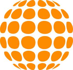

Hi again,
I'm trying to follow a tutorial where one of the final results is this: http://i230.photobucket.com/albums/ee124/joaclint/joaclint_istgud/inkclon3d.png.
Starting from a square, he clones it and then apply "interactive deformation" (not sure if that's the correct English words for that). Can someone give me an idea of how to get the nice sphere?
Thanks.
Mauricio

"interactive deformation" is a perfect description of what the Envelope LPE does. But looking at the images in the tutorial, it looks like the author is using node sculpting. (which could also be described as interactive deformation) It looks like he or she is selecting all the nodes in a compound path, then using Alt + drag from certain key nodes. It's not at all clear exactly what happens to create the final result.
I'm not sure what druban has in mind. But one thing you could try is Envelope Deformation LPE (Path menu > Path Effects > Envelope Deform.). Of course you could also try node sculpting, but it's not clear to me what kind of object the author starts with. Does he have an array of tiled clones, and then does the node sculpting? Or has he started with the grid of squares and somehow gets to the circles?
I've found the Bing translator to be a little more accurate than Google http://www.bing.com/translator/?ref=SAL ... &mkt=en-US. Maybe you could translate the entire tutorial? There still would be some questions, but we might infer certain things by having the illustrations together with English text. Like google, the bing translator is free
Re: Clones and deformation
It looks like he has taken an array of nine squares and dragged the nodes bit by bit using the sculpt mode of the
to make the approximate shape of a quarter circle. Then he makes 3 copies to make a sphere like shape.
Then change the nodes to smooth nodes maybe to get rounded corners? It's the alt-dragging that's not exactly clear. He is probably selecting and deselecting and slowly making the image into the desired shape, there's no way for him to explain exactly which nodes he dragged! Maybe in a movie...

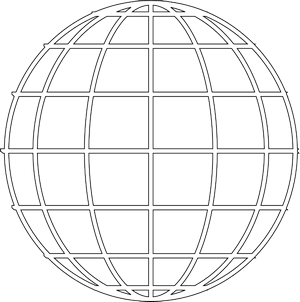

What a lot of work!
Instead, try this:
1.extensions >render >wireframe sphere. Latitude 7 longitude 14.
2. Ungroup twice. You will have 15 ellipses. Delete the outermost one.
3. Object to path. make the stroke slightly wider.
4. Stroke to path. Union. Break apart. Oh no! Everyhting's turned black! Relax. Change the fill to none, stroke to some value and narrow. This is what you should have.
5. Delete the outer path and the little paths top and bottom. You should have 36 paths. From this point you can decide how you want to make a smooth shape out of each one.
Here's one way.
a. Throw away 3/4 of the paths, keeping one quadrant. Easier to work with and you can just clone it 3 times at the end.
b. select all. You might have some six node paths etc, so control -l to simplify.
c. In the Transform dialog. Scale them all to 50%, proportionally, each object separately.
d. Switch to the Node tool. select all.
e. Shift U or (control bar button) to convert all segments to curves.
f. Shift S (or C.B.B.) to convert all to smooth nodes.
g. Scale the objects back up in small increments. I used several repetitions of 105%.
h. Group or combine the 9 paths and Clone it 3 times. arrange the clones appropriately.
i. Now node edit the original path, the clones will update as clones do, saving you mucho work. In my example i didn't do any editing, but of course it would have looked better.

Since I couldn't get the circles to work with a combination of tiled clones, I thought of just making 1/4 of the array, and then just move the rotation center, and clone 4 of them radially. But I got into trouble with that, as well. It's much easier for me to just "manually" draw, rotate, and position them, than to use a fancy trick or technique. Although I did use a little bit of a trick in the end.
So here's the compound path. Notice where the center of rotation is. I used snapping to intersecting guides to place the circles in the right arrangement
Next it's duplicated and rotated 90 degrees, until there are 4 sections making a whole "array".
And next, the magic with Envelope Deformation, which was my original thought in the first place
. Notice what I've done with the bend path. The same is done to each of the 4 sides. I used a grid and snapping to make sure the bend paths are all symmetrical.
After that, it appears the the tutorial author added some shading and highlighting objects, on top of the base circles. They look to me like perhaps a complex clipping path (or 2 or 3) was used. But it's hard to say for sure. Then of course the cast shadow to make the floating appearance. I'm sorry that I don't have time to sort that all out for you.
Like with druban's effort, there are some distorted circles. They can probably be fixed by finessing the bend paths in just the right way. Compared to what we have speculated that the tutorial author did, this was probably much faster. But by the time you work out the shading, shadows and highlighting....well, still maybe a little faster, depending on your skills. Or maybe just as long, it's hard to say.
So anyway, for whatever it's worth, that's another way to do it
