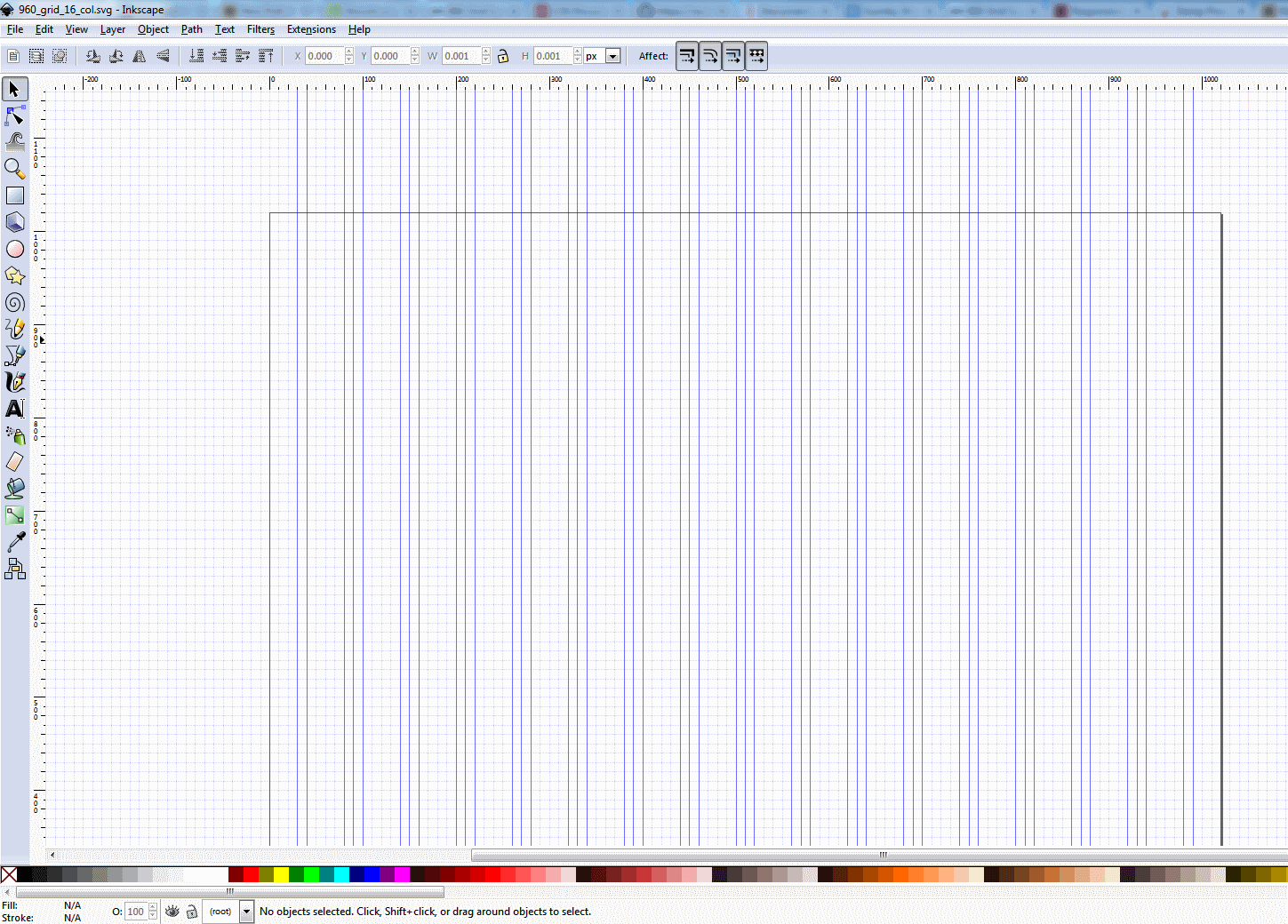

Being relatively new to both web development and Inkscape I've only just realized the issues with the grid system I implemented.
The 960 grid system in Inkscape is a document with pre-prepared guides.
Because I've only just discovered CSS frameworks, I've now decided i need to try various other grids.
Is there some way to copy and paste multiple guides at once? Or move multiple guides at once?
Applying Multiple Guides to Inkscape

If you want to draw guides in a fast way, then you can try the convert to guides option by pressing Shift+G when objects are selected.
Here is a description of the method in a nutshell, to create grids like on your image:
Draw three vertical paths, group them together-or alike,
use the make tiled clone option,
disable clone link,
and press Shift+G when all is selected.

Unfortunately there are no way (that I can figure out) to select more than one guide at a time.
The guides extension in Extensions - Render - Guides can be programmed to implement the 960 grid system.

The other grids I wanted to test are 960 split into other proportions.
The problem is I made easy unstructured mockups to see if I liked the feel, now I need to convert to proper sizes so I can build them.
Lazur's solution worked really well. 960 comes with inkscape grids you just can't move them and the document size doesn't work well.
I drew lines down using the existing grid then I can paste them into whatever mockup I'm using and use Shift G to create the grid. Cheers all!

Another solution would not to move the guides, but to do the opposite: to move all drawn elements, and move the page if necessary (meaning, changing the canvas, using an existing selected rectangle as new canvas).
For your information: I am currently working on making a column grid plugin that could take as input
- number of columns
- column size
- gutter size (spacing between columns)
And then output all the guides automatically. Either left aligned on the document, or centered.
I am using the Guides Creator plugin as a base - it can draw columns guides, but not with gutters.
I'll post my plugin when it's ready.

I have made a plugin to create a grid of guides, for making columns and gutters. (The center guides are not added automatically, but they can be generated as a separate grid). Download from the Grid Maker github page. The grid extension is now part of this bundle of extensions: Inkscape Guide Tools - you'll find the description and download link on that page. It includes generating a grid of guides WITH middle guides in the gutters (latest version, compatible with Inkscape 0.91, not compatible with 0.48)
