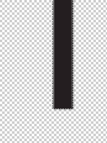

hello! I am making designs for a t-shirt printer. every sample I send they say has invisible pixels. how do you avoid/get rid of them and also check to see if they are part of your work? I have fair knowledge of Inkscape but haven't worked with the grids at all or had this pixel problem.
I also have another question: how to outline text for t-shirt printing? I've tried stroke paint and object to path and am not sure which is correct.
fyi: I am even getting invisible pixels on my text when I outline. I have attached an image from my sample that they sent back to me

That is a raster image while inkscape works with vectors. If you send them over a pdf instead they should have no complaint about the fading edges of anti-aliasing.

thanks very much for your replies.
I should have mentioned that I am using scribus with Inkscape (since I have to convert to true colors). I export the PDF files from scribus. sometimes I import them into scribus as a PDF file (saved as Ink.PDF) and sometimes as Ink.SVG files. I have tried exporting PDF from Inkscape and again exporting from scribus and it still ends up with invisible pixels.

I have tried converting to paths. I am sure I’ve done it right before because they said text was outlined and didn’t mention the invisible pixels at first. when saving PDF in Inkscape - the boxes where it says ‘convert text to paths’ - I don’t know whether to check it or not, especially if I have already converted them. I have tried both ways and still get pixels. (and La tex? I have no idea)
The opacity is always at 100%. I know it’s something simple I am missing. I have attached 2 files, just simple text outlined with object, The first is PDF from Inkscape, the second one is PDF from scribus (imported from Inkscape, into scribus, then re-exported as PDF).
what I really want to know is any idea how to check for these individual pixels myself? I’ve tried pulling the images into Gimp but even on the checkerboard it imports with white background. Any ideas?

the pdf doesn't tell me much but the background IS transparent. see how this works...
