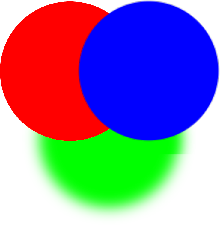

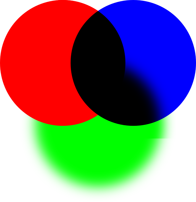

I have attached a simple test file: The red and green circles are on Layer 1, which has Normal Blend mode, the blue circle is on Layer 2, which has Multiply Blend mode. Moreover, the green circle has a Blur of 10. In Inkscape, everything displays as it should (i.e., the green circle is blurred and the areas where the blue circle overlaps with the red and green circles are black, see Filter_in.png). Now when I export this to PDF, the overlapping areas are not black, so the filter is not preserved (see see Filter_out.png). However, the green circle is still correctly blurred, and when choosing a lower DPI, the blue circle is visibly pixelated and thus it is clear that it is indeed rasterized - but without the filter.
