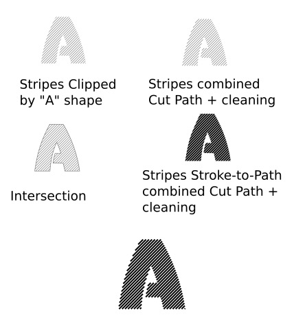

Sometimes Inkscape doesn't execute some actions.
In this case, we want to execute "Intersection" action or "Cut Path" action. Neither one nor the other is executed.
The strings are paths and the Text letter is also a path.
What I missed to accomplish what I want to do with Inkscape.
The final result is obtained in the same conditions with another software, as shown below the file in attachments.
Sometimes inkscape don't do what we demand to do
- intersection , cut path.svg
- (62.37 KiB) Downloaded 72 times

I didn´t work in first place because the "A"s are a group coming from converting text with Object-to-path.
For the second on the right combine the stripes first to make a compound path - then use Cut Path and go for a good cleaning up.
If you don´t need just the path building you can clip the lines with the A-shape via Object->Clip->Set
There are other possibilities:
- AlternativeBoolean.svg
- (181.05 KiB) Downloaded 70 times

Tkx Polygon,
I'm not an expert, I'm an intermediate level in Inkscape.
For "Stripes Clipped by "A" shape" = It's ok for me
For "Intersection" = I can't do this. When I select all the elements and apply the "intersection" command, nothing happens! It happens to me all the time. When I have for example many shapes and want to "unite", "divide", "intersect"... I can't do this. But I do this with the other software easily.
For "Stripes combined Cut Path + cleaning" = I combine stripes and apply "cut path" command, I obtain no result. What's cleaning?
For "Stripes Stroke-to-Path combined Cut Path + cleaning" = the same as above. I apply "Stroke-to-Path" to stripes and combine them, then I apply "cut path". Also, nothing happens! What is cleaning one more time?
Are there any settings in My Inkscape, which I missed?
Can you please intersect the shapes in a file in attachments with a simple command "intersection"?
It seems When we have several shapes at the same time or a grouped shape, Inkscape don't do "intersection" or "difference" etc... Am I wrong?
- Shape to intersect.svg
- (11.47 KiB) Downloaded 67 times
Re: Sometimes inkscape don't do what we demand to do
Boolean operations such as the ones you are talking about only operate on paths, not groups.
All Boolean operations work on multiple paths. However the only predictable or logical ones to use on multiple paths are Union and Intersection. All others are performed in a top down fashion which does not always produce the expected result. selecting many PATHS and doing a Boolean will always work so if you are not getting any change one of the objects is not a path. Check the very important STATUS BAR at the bottom of the window for information on why the operation has failed, most often it will be "One of the objects is not a path"
"Cleaning" in this instance means that the cut off parts of paths must be manually selected and deleted after the Boolean operation. It may seem that "nothing happens" as you say but in fact the paths have been divided in two (or more) pieces. A little like when someone's neck gets sliced through and it looks like their head is still attached ... until they try to nod ....
About your file:
1.Inkscape and SVG does not allow multiple paint styles for one path, so the stripes have to be separate paths.
2.The intersection operation uses the filled parts of paths to compute the path enclosing the area that is covered byALL the paths in the operation. Therefore your unfilled ellipse is not going to work, and since none of the colored rectangles overlap each other the result is NULL as well. This is why everything vanishes.
For the example you have provided the clipping operation is more suitable. You can use Booleans by repeat operations or division but you will have to recolor and perhaps redraw parts of the stripes afterward.
Finally any interpretation of "intersection" that will produce that result given that input is just mathematically wrong. If you are in Illustrator grouping is probably necessary?
About your file:

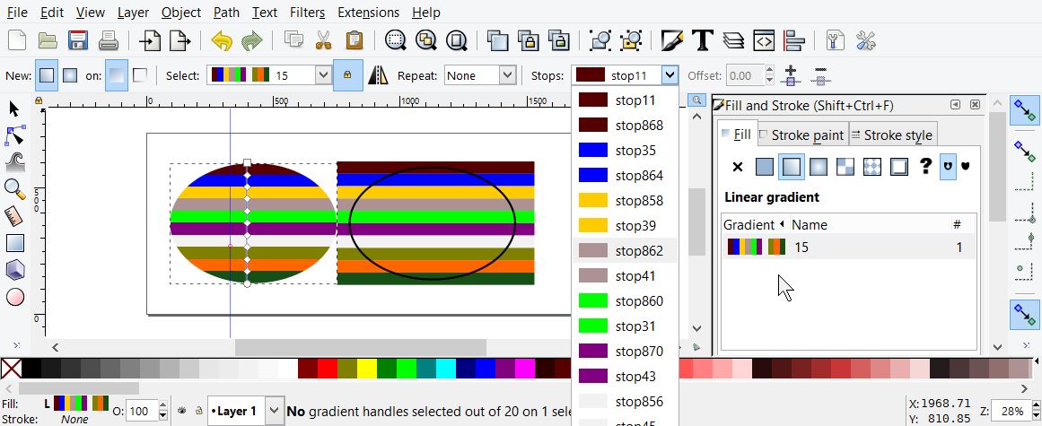

druban wrote:...1.Inkscape and SVG does not allow multiple paint styles for one path, so the stripes have to be separate paths. ..
This is quite true.
And yet there is also a technique to make color stripes using the Gradient tool. It requires two stops per color, with stops on top of each other.
This technique might come in handy if the stripes are needed for multiple objects.
- Stripes.svg
- (9 KiB) Downloaded 67 times
