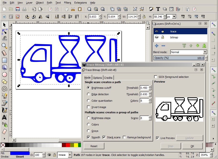

Re: Change The Line Colour of a PNG
This help?

You can't change anything in the PNG with Inkscape. You'll only be able to change it after you convert to vector. Even though the imported PNG image is in the SVG file, it still is a raster image, and Inkscape cannot edit it. Inkscape can only edit the paths you created with Trace Bitmap.
