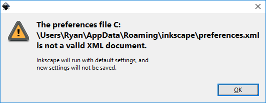

After many years of using Inkscape, this morning I get this error dialog. Amy ideas?

You can rename (or delete) the xml file.
Inkscape will create a new one with default settings when started next time.
(I would rename it "problemPrefsXML.svg" and post it up here for examination.)
Did you have a crash, or did your antivirus update recently while Inkscape was open? Anything like that? What version and system info?

No crash or update, while Inkscape was open, that I am aware of, Windows 10, Inkscape 0.92.4.

Well I renamed the file, but is a file size of 0 kB, so I am thinking it just went "poof" However a new preferences.xml is in the folder, and no error when opening Inkscape. Good to go for now.
