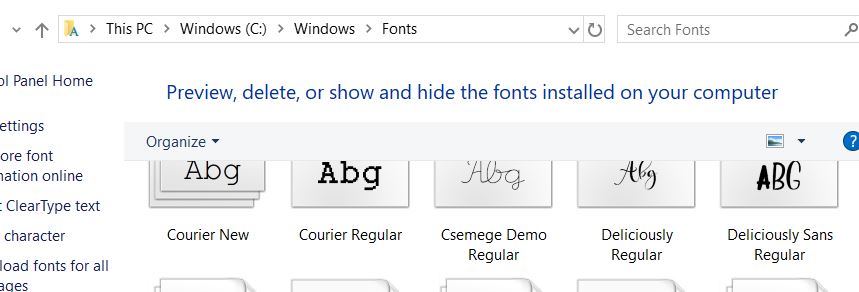

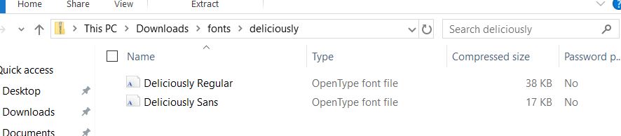

I am struggling with a missing font that does not show up on my list in inkscape. I've read countless similar posts and been pointed to "bugfixes" but I am not sure how to solve the problem. The font is an opentype, saved on my system, unzipped folder, saved in windows font. I am able to use this font in all other programs on my computer. I have uninstalled, reinstalled, open and closed program, turned off/on computer. I have only been using inkscape for the past couple of months so I'm still learning. And I am no computer expert but I know some.
- They are present in the windows font folder

- Deliciously is showing up on the inkscape list
Deliciously Sans is missing - deliciously clip.JPG (30.59 KiB) Viewed 7614 times

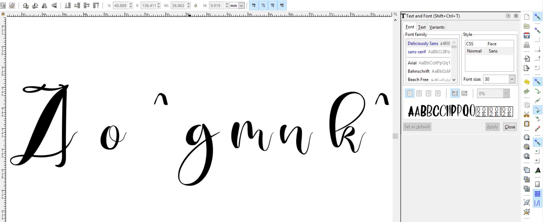

I followed tutorials on how to change the name and "family" then finally figured out how to generate and save it properly. But now I get this . . . .
What did I do wrong now?
Re: Missing font
I can't say what exactly went wrong there, but I'd simply use that font (regular) as it was (from the source). The sans version was the original problem and it does not seem to have the kerning problem the regular version has after processing with FF.
