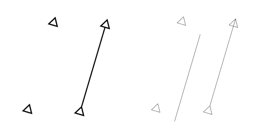

In some cases it might be desirable to place markers along a path but without having the path visible. The idea is to draw a path with markers and set the line width to zero. Actually, I would have expected that the markers also disappear. However, they don't and moreover they show a inconsistent behaviour:
1. draw a path, set stroke e.g. to 1 mm
2. choose start and end markers
3. set stroke to 0, markers are not gone (what I would have expected)
4. move this path: path is moved but markers keep size and stay at the same position (bug!?)
5. if you duplicate this path, the markers of the duplicate are gone
Left: Two paths (left stroke width 0.0, right stroke width 0.5mm)
Right: outline view
Do others also observe the above mentioned strange behaviour with line width zero?
If I look at the Fill&Stroke Dialog (Shift+Ctrl+F), apparently and unfortunately, the marker size cannot be set independent of the line width. (--> Feature request?)
Any ideas to realize an invisible path with visible markers?
As I understand the markes always have the same color as the stroke. I haven't found yet a way to have different color for path and markers. If I could make just the path fully transparent (i.e. opacity 0%) the problem would be solved.
... of course, I could do "stroke to path" but I am hoping for a better solution.

When I change the stroke width, the marker size changes proportionally.....for the most part. When I put the stroke width at 0, I can still see the marker, although I can't tell what it is - it just looks like a tiny dot. Although if I zoom in, I can see it's still the marker. It seems like the marker ought to disappear. Although if you wanted that, you could just remove the marker.
I agree that there ought to be a way to make the stroke disappear and leave the markers visible.
If I change the alpha value for the stroke, as Lazur suggested, the markers are also affected. Zero alpha, zero visibility of markers and stroke both.
I wonder if there might be a pref affecting this? Because it really needs to be possible to hide the stroke.
Ok, in Inkscape Preferences > Behavior > Markers, are 3 options. Maybe changing those can help? I'll try. But for sure, you can make the markers a different color from the stroke, by changing the pref. "Color" might include transparency (alpha or opacity).
Oh yes, it does! You just need to uncheck the appropriate option.

Thanks, @brynn, for clarification. In contrast to me, @Lazur probably had these options already unchecked.
As I want to change the color of the line, in terms of good usability I certainly would expect an option or hint in the Fill&Stroke dialog... well, there might be a reason to do it this way...
