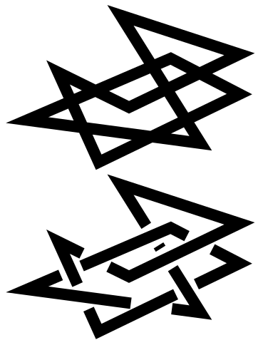

Oh hey! I just got it to work for the first time! Must be the new version of Inkscape. SVG file attached, if you want to look at it. PNG for convenience.
With the Knot LPE, the path remains as a single object. And you can see from the attached PNG, that the gaps in the path don't necessarily adapt to the angle of the line where it crosses over. I'm not sure if there's a way to make it look more realistic.

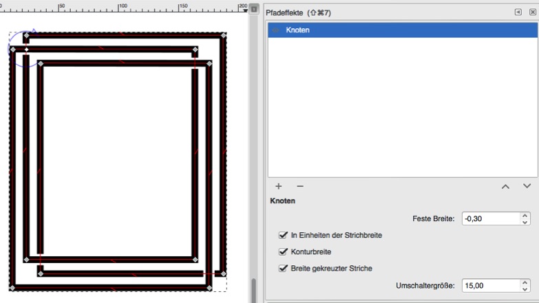

Can´t confirm - works for me right out of the box - even with open paths:
Diagonally drawn or curved lines are of course not covered by the tool - but are not tackled easily manually either.

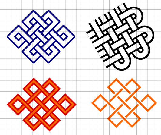

Rendering knots/z-order loops is always tricky. Personally I never used the knot lpe for that. Depending on your final output making separate "weaves" may need a different structure.
Like, will there be a stroke and a fill in the output, are there going to be cast shadows etc.
The knot pattern attached above would produce rendering gaps if it didn't have strokes.
Check out this image for an example:
svg source
This one can be adjusted to have different stroke widths, doesn't produce any rendering gaps even if the black outlines are removed.

OK, here is one with the mentioned overlapping structure -each part was drawn with strokes and no fill, so the width can be adjusted later on.
