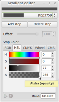

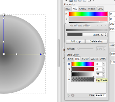

Re: Transparency of objects
Merry Christmas
By default Inkscape creates new gradients with one stop at full opacity, and one at full transparency. You can easily make the transparent color fully opaque by moving the transparency slider all the way to the right ( setting opacity at 255 ) and then change the HSL color value with the color slider, to get the lighter opaque color for your gradient. Check the alpha channel for the basic fill if this happens again when using a flat color, someimes if you've used transparency on an earlier created object the color fill on new objects might be set to the same alpha value.
- Adjust Alpha
- Gradient_color_opacity.png (38.98 KiB) Viewed 16100 times
- Adjust color value
- Gradient_color_slider.png (64.37 KiB) Viewed 16100 times
