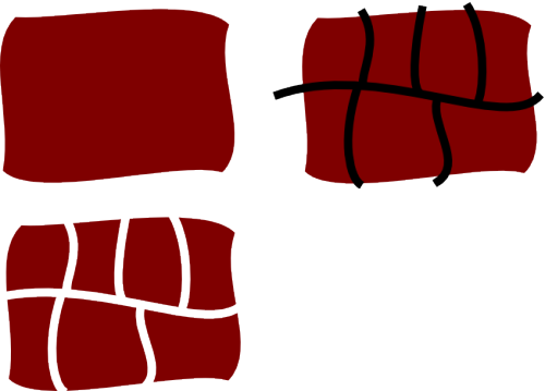

This is just the start to give you an idea:
- Draw a funky square
- Draw lines over the square with a nice thick stroke to divide for each character. Then convert each line using "Stroke to path" then select all the black lines and do a path > union.
- Select the black lines and the red square and do a path > difference
