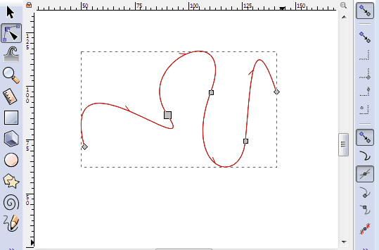

I was just surprised to see that you can snap to extremal points of a path.
So, just in case somebody else might find it useful...
- set snap to path intersections
- select your path
- use the node tool (F2) and move close to one of the path extremes
- double click if you want to create a node there
But why is it called "Path Intersection"? There is no second path. Intersection with horizontal and vertical tangents?
Anyway, it was new to me and I find it a useful feature which doesn't seem to be documented (correct me if I am wrong).

Interesting! Perhaps make a bug report, for the strings to be fixed (the button should say "... and extreme points", and the snap message should say "snap to extremum" (or similar)? It seems to be new in 0.92, tested with 0.91 + 0.92.2.

So it seems to snap to points of horizontal and vertical tangents or whatever experts would call it.
@Raspi, yes, could be... but it's not limited to just min/max of the path but works also within the path...
