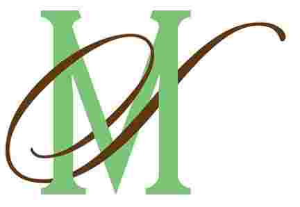

I have just started experimenting with monograms in Inkscape & indeed they are fun. In addiditon to the link provided by brynn, check this link out although you may be pass that stage already: http://forum.make-the-cut.com/discussio ... -intial-ti . Please accept my apologies as I do not intend to hijack your thread but since we are talking monograms please allow me as I have been trying very hard to creat this interweave monogram re: attached to no avail. Help anyone? Thanks.

Is it for a cutter/plotter machine? If so, I think you'd be better off drawing it from scratch, rather than using Trace Bitmap. Use the Text tool, of course, to type the M, then Path menu > Object to path to convert to path. You could probably use the Callipgraphy tool to make the swirly ribbon thing. But when it comes time to do the under/over effect, the only way to do it is with node editing (break the path where it goes under, connect the ends, and snap to the edge of the M). Then if it IS for a cutter, you can use Path menu > Union on a duplicate to get the cutting line.

brynn wrote:But when it comes time to do the under/over effect, the only way to do it is with node editing (break the path where it goes under, connect the ends, and snap to the edge of the M).
Well, maybe not the only way...
Personally I would use a clipping path to get the under/over effect. This has the advantage that your original letter and curve are intact so it's easier to tweak or move them if you want to. The downside is that the clipping path could be complex. Here's one approach:
1) Draw your curve on top of the M
2) Duplicate the curve then use Path > Outset to grow it so that it easily covers your original curve. This will become your clipping path.
3) Change the style of the clipping path to make it easier to work with (and to get to the original curve below). I usually give it a bright green or red stroke with no fill.
4) Use node editing to break the clipping path where the curve needs to go under the M. As a rough first step you can use
in "Cut out from objects" mode to quickly remove the parts of the path that you need to, then zoom in with
for some tweaking and tidying up.5) Select both the curve and the clipping path then use Object > Clip > Set
If you need to tweak it later, you can use
on your curve, ensuring that the "Show clipping Paths..." toolbar button is pressed in to allow you to edit the clipping path as well without having to release then re-set the clip (though you might prefer to do that anyway).Re: Creating Shaped Monograms
