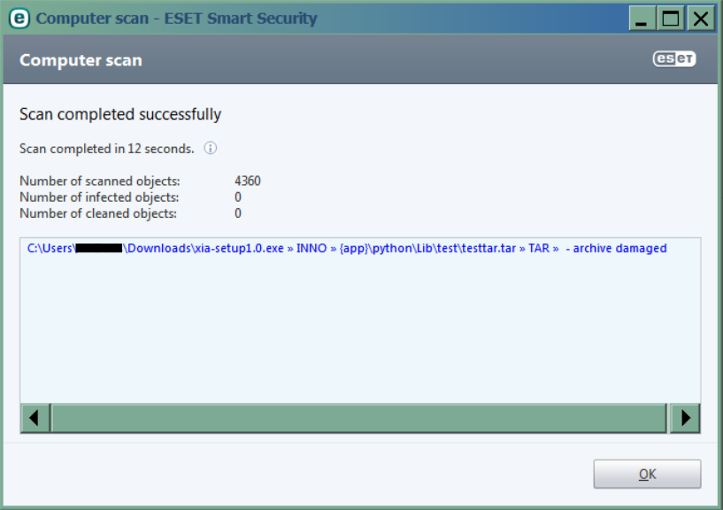

Hhmm....I'm not sure the significance of this. Of course I routinely scan all files that I download from the internet, as everyone should, for security issues. I'm not sure if this is exactly a security issue, but maybe something you want to know about. I have not tried to install it yet.
Spybot S&D (dinosaur, I know) and (more currrent) Malwarebytes Anti-Malware report no issues.
Re: [Extension] XIA 1.0
ok. Thanks for this report. I will have a look at innosetup issues. If you want to have a look at source code, everything is under GPLv3.
