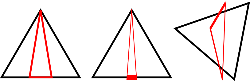

If I scale a polygon in one direction, e.g. a triangle, I would expect the result shown on the left.
(back=original, red=scaled) However, Inkscape creates the result in the middle.
As you can see in the sketch on the right, apparently the thickness of the scaled line depends on the angle of the line.
The option "When scaling object, scale stroke width by the same proportion" is switched off.
Bug or feature? Any ideas to avoid this?

Attached the simple example from above as SVG... the left shapes was created by converting the triangle to path first, but then I loose the properties and features of the triangle. This strange scaling also appears with a tetragon (from the polygon-tool) but not with a rectangle (from the rectange-tool).

Convert it to a path, to remove the transform. The transform, by definition, transforms the whole object, including its stroke.
As far as I know, this is just how things work. You cannot have both for polygons that are symmetrical by default.
For rectangles, Inkscape provides a way to move the info from the transform matrix that applies to the whole object into the rectangle width/height values, for convenience, when resizing. Same for ellipses. This calculation is just not possible for stars/polygons. Maybe if you used a path effect to create the star, then it would work.

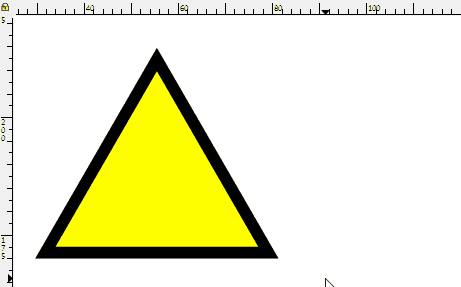

However, another strange observation (see animation):
1. if you duplicate the triangle and squeeze it the stroke will get non-uniform within the triangle
2. if you duplicate the squeezed triangle and convert it to path (Shift+Ctrl+C) the stroke stays as it was
3. ONLY if you move the path-triangle the stroke gets suddenly equal on all sides. Isn't that pretty strange? Is this some stroke-width updating problem?

A stroke is a stroke and can be scaled or not
Yes. The stroke can be scaled.
However, what you're doing here is squashing the whole figure, and that figure cannot change in its width, because it is a same-sided triangle, and always will be. So all you can do is squash the whole triangle. You can scale that triangle's stroke, but it's still going to be squashed.
Yes, and if you had different settings in your preferences selected, that make sure that transforms are kept, then it wouldn't even change if you move it.
No, the reason is that the transform is still applied to the figure. When you move it, the path data will be rewritten to eliminate the transform matrix that squashes the figure. This will move the actual nodes into their correct places.
