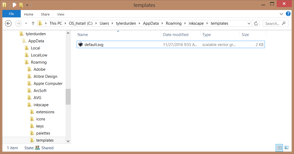

You can set your own default.svg by setting the Document properties as you like them, and saving the file (default.svg) in your user profile:
(assuming Windows) ..\users\yourUsername\AppData\Roaming\Inkscape\templates\
Then, when you launch Inkscape, the default should open as a "new document".
When you upgrade Inkscape, these users folders should persist, keeping your custom symbols, templates, extensions, etc.
- templates_2017-03-17_12-39-54.png (49.03 KiB) Viewed 1440 times
