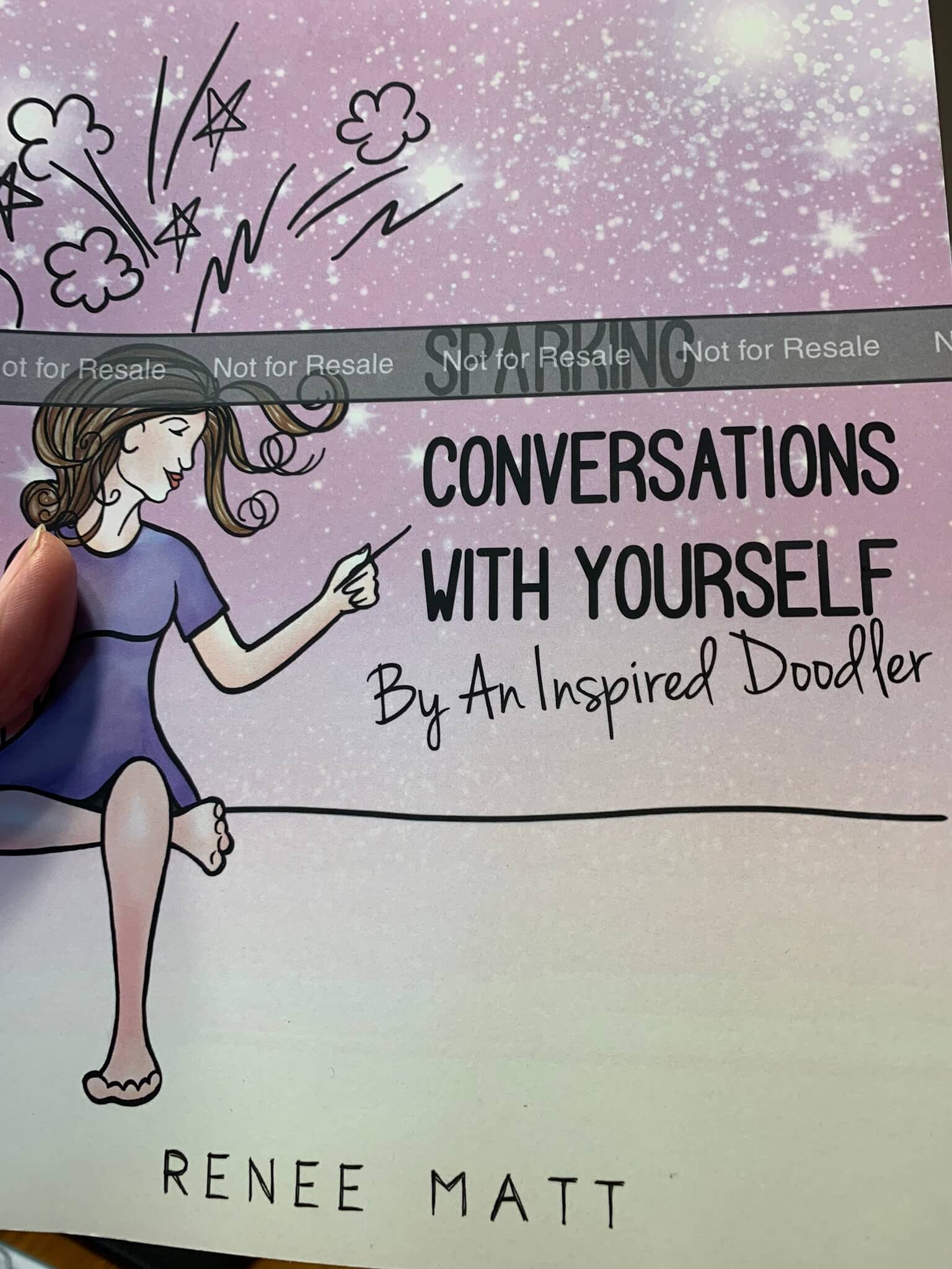

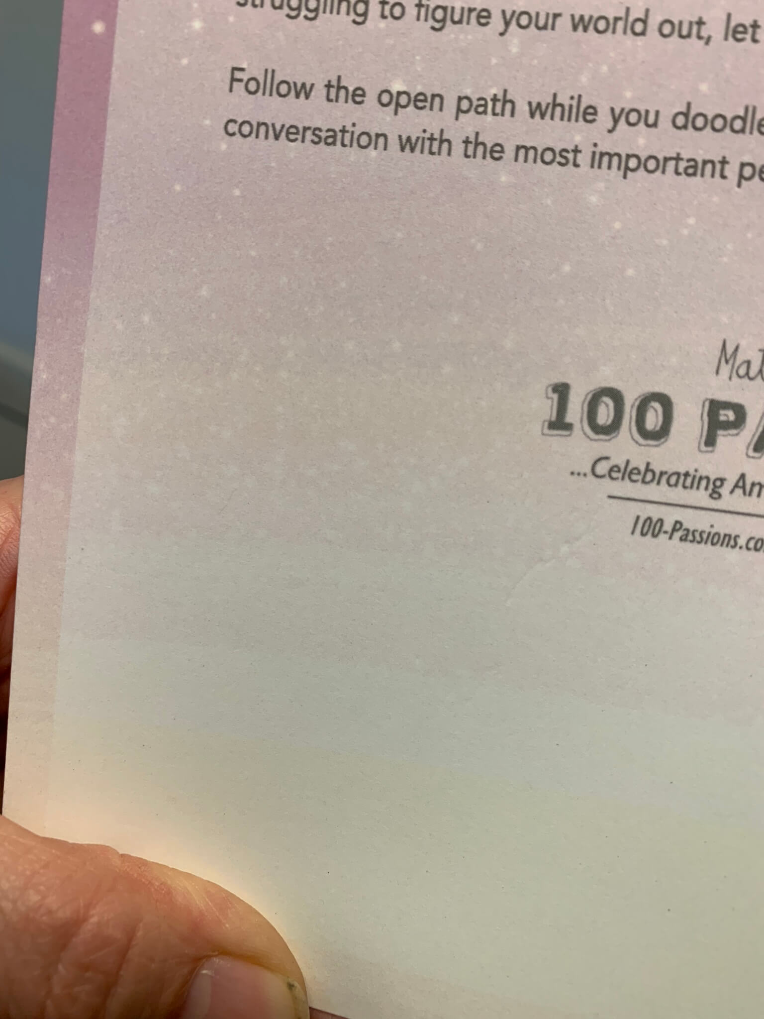

KDP recommends converting spot colors to RGB or CMYK. I am attaching two examples of the banding. It is only on the lower part of the cover in the lighter area.
Please see two photos I uploaded, thank you. Thanks for the advice on the other art programs, I had never heard of Krita, looks interesting. I use ArtRage for my line drawings and coloring, but I don't like it to work with the text. So you are saying that perhaps Inkspace is not the tool for the job here? I am pretty happy with it except trying to clear up this banding issue. Thanks, RTM
- banding on jpg
- IMG_0512.jpeg (175.12 KiB) Viewed 3288 times
- banding on jpg
- IMG_0510.jpeg (255.08 KiB) Viewed 3288 times

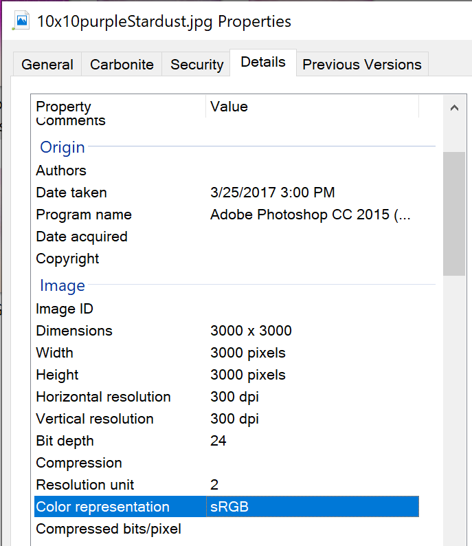

3. I thought to actually check what file type the background is, and it is RGB - image attached. I should be able to convert that myself to CMYK? I do have access to photoshop.

- stardust-properties.PNG (40.68 KiB) Viewed 3234 times

Signs of banding were still there. Then it dawned on me to play with the contrast, which I actually first did in Word. It was glaringly obvious of the banding. The thing was my gradient to the visual eye had washed out to a near-white, so it was almost impossible to really see what was going on, unless I used contrast.
Then I thought, a ha! I will just "wipe" away the band by using the "heal" tool in Photoshop* which I had some past experince with. I also had been satisfied with the RGB color that was printed, so I ended up leaving it as it was and submitting a proof book. I was surprised to see a wavering white mark on the cover when I got the book back. I could see that was not the tool for the job.
Next, I spent time in Photoshop with Image>Adjustments>Shadow>Highlights, moving the meter all the way over to 100% highlights. There I could see all the flaws in their full glory. Then I had the idea of that I will just put a solid rectangle of color on the bottom and blend it in myself, but ended up just working with the original image using suggestions from this video: 4 ways to blend in Photoshop https://www.youtube.com/watch?v=L_FLsXz3yyQ using such techniques as smudging, and the paint brush blending.
I had what I thought was a pretty good looking image, then I went to look at it in Image>Adjustments>Shadow>Highlights and it was a mess. It was obvious that was the same approach the original artist has used. You could see the hand-strokes of blending in. So this was a two-fold issue: banding due to RGB and blending techniques in Photoshop - a "junk out" problem!
So drumroll... I had to go find a new image (: But first, not to quite throw in the towel, I had another Idea (I am really full of ideas) to find a transparent stardust image and lay it over a gradient I would make myself. I purchased an image in EPS format (I am still working between Inkscape and Photoshop). Of course I could not open the image in Inkspace until I added that whole Ghost script thing (Inkscape's requirement for viewing EPS images), and then had to figure out how to remove the checkered background using Photohops that was added to the file. Ultimately, I was stopped because I couldn't figure out how to remove a gray background in the image.
I think there was some advice initially to find another image and stay away from gradients. I can only say that gradients are best left to the experts. I believe I was also warned to really examine my image close up. I have certainly gained good advices and new resources along the way. I just uploaded the new book cover this morning, and will see how the proof turns out!
*I am not a Photoshop user, I am borrowing a copy.

Sorry you had a frustrating time there. It's always a temptation to start doing this or that in PS to see what happens and before you know it you on an island in the middle of the Pacific with little bits of aircraft around you. If something doesn't work best to revert and try something else.
Banding is best avoided by redesigning the RGB gradient in CMYK. Converting an RGB gradient to CMYK is simply not ever going to give you smooth results.
Having said that, fixing the banding is usually productively approached by looking in each channel to see which ones are banded and then using blur to fix it. Unfortunately it sounds like it's too late this time
