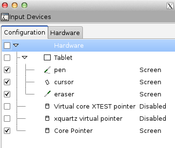

I tried it both with xquarts pointer enabled and disabled (see attachment). I tried "screen" and "window" as well, but the dialogue is a bit cryptic, so I don't know what that changes.

I need to disable "cursor", using the menu that says "Screen", on the right of the screenshot. That seems to have fixed the problem, and I get to keep all the functionality of the pressure pen.
