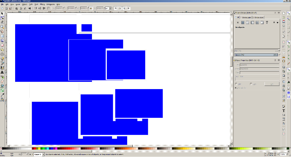

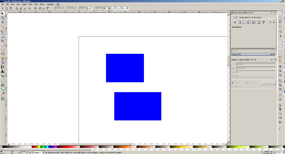

I was thinking about moving to Inkscape but I am having a major issue does anyone know of a solution?
Whenever I zoom in our out I get major ghosting which stays on the screen until I scroll away and back or minimise or move another program in front.
Here is an image of two blue rectangles
Here are the same two blue rectangles after I zoom in and out a bit.
My video card is an Asus GTX970 and I'm using windows 7 with all the latest updates.

Vectorator wrote:I wonder whether any inkscape programmers have seen the bug report yet.
It got into the triaged status, so yes, wheels are turning.
Re: Multiple ghost images that stay on screen when zooming
Vectorator wrote:yes lol I made the bug report.
I was just wondering if the people who replied so far were people who users who were interested to help test it out or if any so far were programmers who might be able to fix it. Also what experience other people had with bugs and how long it could take to fix.
I'm hoping it's a really simple thing to fix for a programmer, just a matter of adding a few zeros for example.
Oh ok, now I understand. Not only triaged, but showing Medium importance. Those are 2 extremely good signs, as far as the attention most bug reports seem to get....at least in my experience. Just a little investigation of Launchpad will reveal some very long-standing bugs. Some bugs I reported 6 or 7 years ago, still aren't fixed. But a couple of reports I made were fixed within a year or 2. It would take a fairly in-depth understanding of how Inkscape development works, to be able to give some kind of "fix date", and I don't have that kind of knowledge. Here's some info on reporting bugs: https://inkscape.org/en/contribute/report-bugs/

Ok thanks.
I wish there was a way I could fix it by making the background rectangle size that seems to be the problem bigger. Too bad I can't program.
I'm not sure if I should buy another program for the time being or not, hence the questions about when it could be fixed etc.
