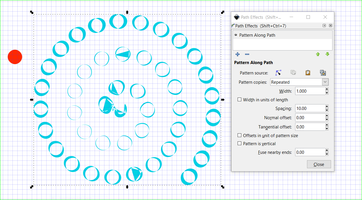

In LPE pattern along path I have used Inkscape's native spiral shape; it's a simple stroke. As a pattern I also used Inkscape's ellipse as a circle. The resulting combination is an odd spiral. The initial pattern circle is a full shape but the path circles lack this fill as you can see in the attachment and have a strange kind of stroke. Furthermore, 5 of the little circles are deformed, needing rehab. Lastly, as one moves into the interior of the spiral the so-called clones are no longer clones. Does someone with experience in these matters have an explanation, or explanations?

you could post the file for an accurate explanation. Several things interact in this scenario, e.g. whether it's converted to path, what the stroke and fill status is, whether it has been scaled, whether other path effects are being used, whether some overlap is present etc., and these are tedious to ask you to check one by one. your output does indicate a slight rendering bug in the stroke I have noticed of late but one of the other causes are more likely.
The paint style is going to be the path's original and not the pattern's, this is expected behavior.
it works for me like this in 92.3... what version are you on?
Re: my spiral is abnormal
We're really only guessing, unless we can see the SVG file.
My thought on the unfilled, strange-looking circles, is that there might be circles on top of circles.
Even if they are clones, being on top of each other could still create such an appearance. But what makes you think they are clones? Is the original a clone? Hhmm, actually I'm not sure if a clone can be used for the pattern. I'd have to test it to be sure, but I think it can only be a path (or maybe shape).

I don't know what is meant by sharing the SVG file; I have shared the problem with an ING file as you can see. I have a few SVG files but they are irrelevant. Druban's multiple suppositions find me perplexed. I am a "newbie" without your experience to tell you what you need. Rather than tinker with LPE I have gone to Scatter. Well, there things are not all rosy either. I have managed to line patterns along pencil curves and bezier curves, but the patterns are all doubled (on top of each other) as they multiplicate along the curve. As far as placing the patterns on a circle, on a rectangle, on a polygon, all that happens is that the path itself shows up doubled up but the pattern remains isolated. All I have checked is "follow path orientation". Doing things with Inkscape is my way of doing something satisfying, something that gives some meaning to leisure time; and if things don't work the way they are supposed to, they can be dispensed with. Oh, one more thing: I have come to a deduction, and it is that the patterns make it along an open shape, such as the curves I have traced in Scatter, but can't find their way around a closed shape. Does that bit of information help in any way?

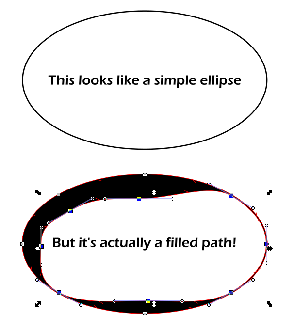

found your problem
at some point this ellipse was converted to a filled path probably with an unintended press of stroke-to-path
Now it is actually two concentric ellipses almost but not quite of the same size. But still one path so Inkscape places the pattern on both of them. because of the small dimensional difference, the pattern appears to be repeated and misaligned on a single path!
It's the same issue with the spiral. I suspect that instead of using OBJECT TO PATH you are using STROKE TO PATH. The Inkscape manual is available in many languages, if English is not your first language. I think there is a French version, and perhaps someone closer to the manual project can direct you or correct me?

It's interesting what you say about the oval and spiral both having a double contour. My fingers seem to be a little too fanciful. I am going to watch and try to keep them in check with my next attempt. When I have a stroke before my eyes I just do the stroke-to-path. But I didn't have a stroke before my eyes... I am just at ease with both Englsh and French (not Quebecois), and have the English version of the manual. I am glad you found the origin of my errors so quickly. Experience is a good teacher!
Oh yes, you need to do Object to Path, but NOT Stroke to Path.
