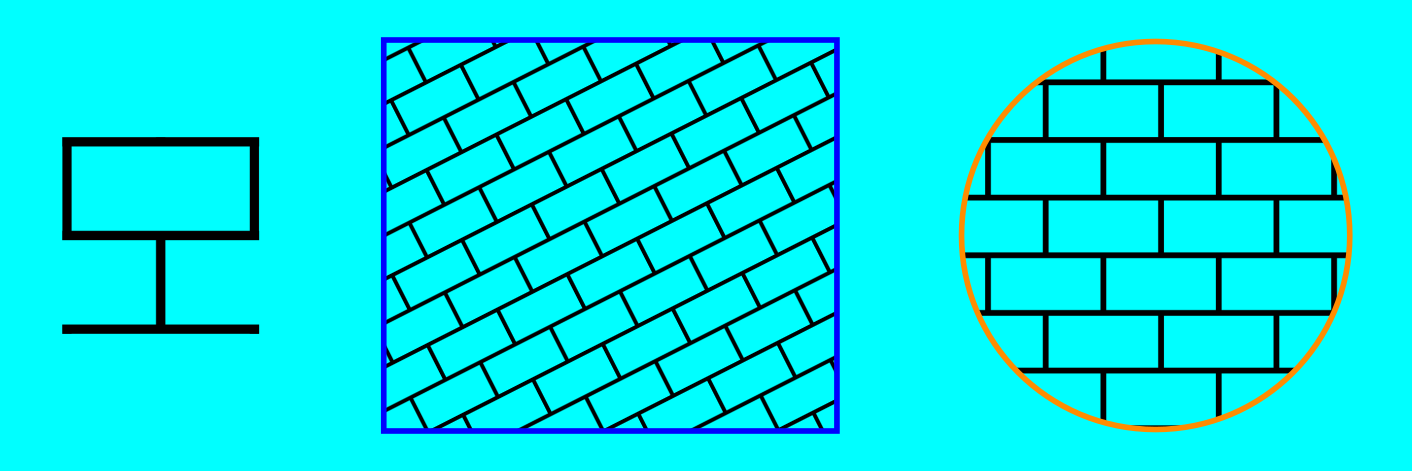

there is an alternative to the clone and clipping path system that Xav gave you (other methods are not really worth pursuing).
You can create a pattern, which is not as straightforward but can be reused over and over easily.
I have attached a file showing the pattern basis and using it in two objects with scaling and rotation.
Making a pattern is simple: select the objects you want to be the pattern, and from the object menu select patterns>objects to pattern. Then, in the fill and stroke dialog box, choose pattern as the fill style and your newly created pattern should be the default first choice, or, you can pick from the dropdown list.
There is one thing that makes this method less than immediate and that is the often necessary editing of the definition in the XML editor to allow overlap. This takes care of any white-line seams (a recurring problem with all pattern fills) or thick lines (specific to grid fills like this one) and is just a matter of changing two numbers that specify the width and height of the pattern.
