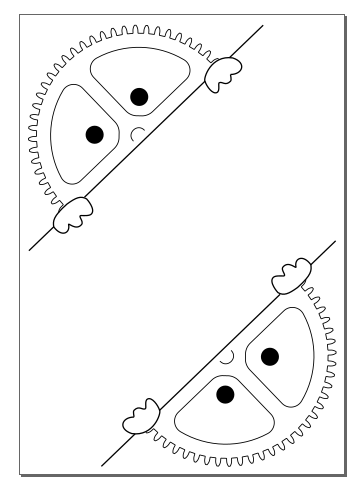

Re: split data to small cnc
Sorry, couldn't resist:
- Bildschirmfoto_2017-04-26_19-15-28.png (40.08 KiB) Viewed 2413 times
Objects with open nested paths will not behave the same as closed nested paths.
