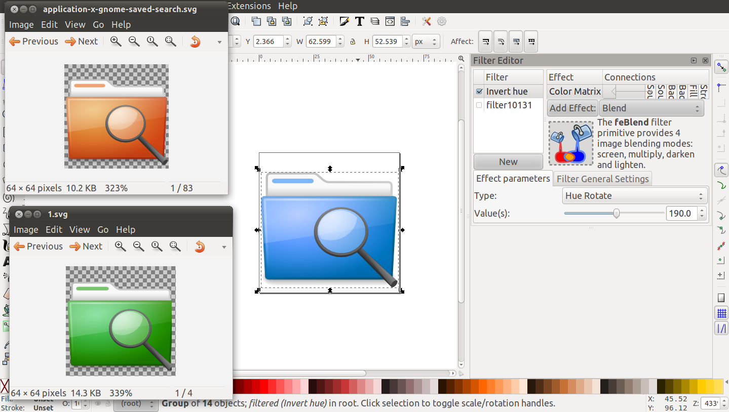

Why is it when I open this orange folder image and change the hue to a more blue it saves green? Thanks

Hhhmmm.....well, I notice that the name of the first (orange) file is very different from the green one. I realize that you might have simply changed the name. But I also want to make sure you're comparing the file you intended to. (No offense intended, but I just like to be clear
Next, I notice in your screenshot that you have the Filter Editor open, so it appears that you're using the Invert Hue filter, and even the Color Matrix primative, to change the color? If I've got all that right, I cannot reproduce the problem.
Would you please tell us your system and version info? Short of learning other as yet unknown info, I"m thinking bug....

Correct. Though I don't know what 'Color Matrix' is yet.
Ubuntu 11.04
Inkskape 0.48.1-2ubuntu2

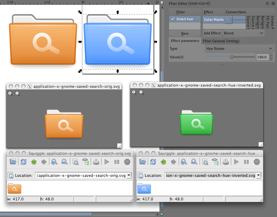

Can you share the original SVG file (attach here or provide a link)?
Could it be a bug (or limited support for SVG filter effects) in librsvg? Which image viewer (as seen on the screenshot) do you use? Can you view and compare the SVG files in other renderers (e.g. Squiggle, based on Batik)?98ds7f98f wrote:Ubuntu 11.04
Re: change hue and save
Reproduced with rsvg-view (librsvg v2.34.0) - compared to Batik (Squiggle 0.18pre) and Inkscape (0.48+devel r10252):
The problem IMHO is not with Inkscape but with librsvg.

Confirmed, with my example, rsvg-view handles the 'Tritone' filter effect better than the color matrix from 'Invert Hue' (looks the same as in Inkscape).ivan louette wrote:Perhaps could you use the Tritone filter. (…)

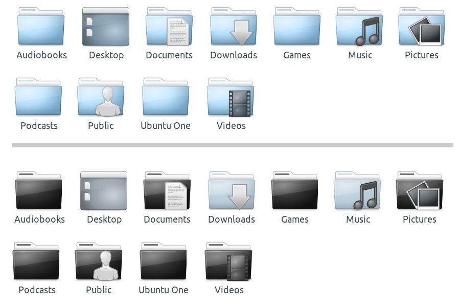

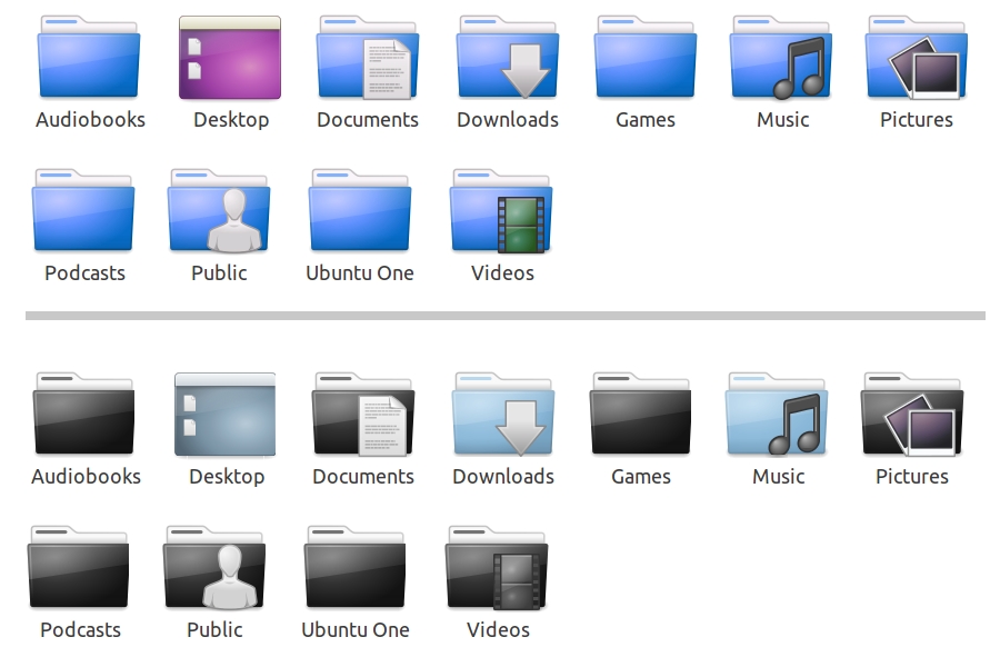

Here's a comparison of the installed Humanity icons with the changed color.
The top set is the Invert hue (Hue Rotate value: 16). They all show up like they should.
The lower set is the Tritone with Flood color #92D2FE (went with a lighter blue for these icons). Notice how most of the icons show up black. :-/

98ds7f98f wrote:The lower set is the Tritone with Flood color #92D2FE (went with a lighter blue for these icons). Notice how most of the icons show up black. :-/
Are you sure you changed the color only in Tritone ?
When I apply Tritone with your blue as Flood to the whole image I obtain the result below (with Tritone no matter which hue was used in the picture).
On the other hand when using Tritone no violine color could remain as that's the case for the little monitors image on the right in your picture.
- blueicons.jpg (54.74 KiB) Viewed 3478 times

druban wrote:Ivan? I may have misunderstood the gist of your explanation...
I only pointed that using 98d's blue as the Tritone filter flood should give the first icon set result of my picture and not 97d's second set. And also that any hue should be replaced by this kind of blue.
