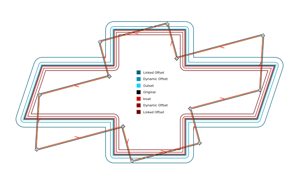

Maestral wrote:Still, I have a question. Does anybody have an explanation why does Inset tends to distort even straight lines (as in this case) when applied? I`ve noticed that distortion is not quite predictable, which makes things even more complicated (at least, for me,) (…)
- There are known issues with very small paths (bug #616469)
- The stroke style for Join and Cap does affect the outset/inset commands (test inset/outset commands with two basic stroked stars, one with miter joins and one with round joins)

Almost forgot to reply and to upload .svg
@ ~suv
I`d really like to hear your opinion about this.
offset1.svg
@ ~suv
offset1.svg

Maestral wrote:I`d really like to hear your opinion about this.
AFAICT the odd inset path depends on the (absolute) path geometry of the original. Try this: select the original path, rotate it one step (15°) - e.g. using the keyboard shortcut [ - then duplicate and inset: for me this result is closer to the expected one (visually, all corners stay cusp and the extracted node handles seem to align well with the straight line segments). Tests done with Inkscape 0.48.2 (OS X Lion).
Path modifications like
- flipping the path vertically and/or horizontally
- breaking the path at the first/last node
- reversing the path direction
- moving the path to a new layer (to avoid any preserved transforms on parent group, and on the path itself)
I haven't figured out yet what actually could be the trigger (in the path geometry).

Thanks.
I`ll pay attention in further usage and post if I got any news about it.

I`ve tried inset with rotation, but on stars (from the uploaded file) and it didn`t worked well. That`s why I have not made any further comments, instead I made a few more tryouts, but just recently I applied it on original shape from the logo and it worked fine/as shown on your picture.
