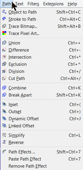

Well, if you mean boolean functions, yes.
They are part of many available path operations... Menu: Path

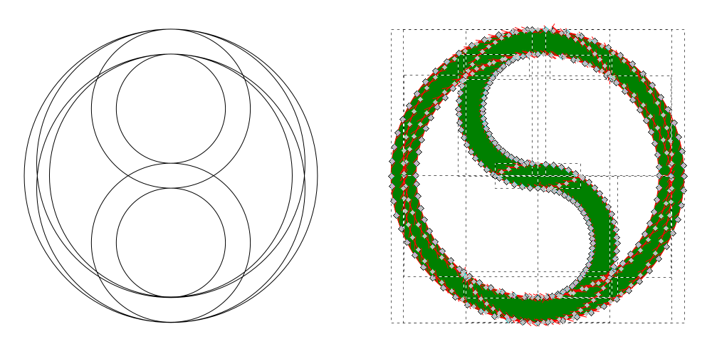

ScrotieFlapWack wrote:I am wondering if anyone knows about the Shape Builder tool in Illustrator. The tool basically allows you to overlay multiple shapes and when selecting those shapes you can combine, remove, intersect, etc, paths.
As the fellow forumers said, it can be done with Boolean Operations. So in your case you draw all the circles, then peform a Combine, add another bigger rectangle, then perform a Division. After that you can delete all the unwanted parts, just as in the video.
However, in Inkscape these actions create an object with a lot more nodes.
Adobe has an edge here, as you can see. Less nodes and no added rectangle needed ! Maybe what Inkscape should do is use the intersection of the paths to create the divison ?

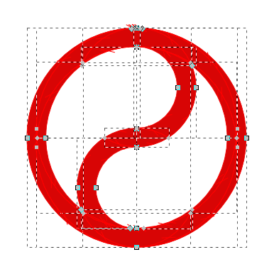

Re: Shape Builder Tool
Seems the "exact" same works better than I remembered.
But if there is only a very little difference, the result is also somewhat unexpected.
Image shows a circle and a bit rotated duplicant intersecting.
