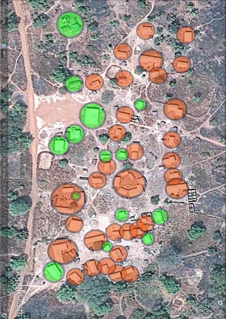

Thanks for your help. But it didn't work as I expected. If you look at the attachment, I started adding information on a map using layers, so the green circles are on one layer, the orange ones on another, while the map is the background. When I select all layers, the background rotate, but the circles rotate individually, thus not moving from their respective position. Should I start all over again, or is there a way to group them and rotate them all so that they get align to what they were aligned with (in portrait) ...

joewusa wrote:Thanks for your help. But it didn't work as I expected. If you look at the attachment, I started adding information on a map using layers, so the green circles are on one layer, the orange ones on another, while the map is the background. When I select all layers, the background rotate, but the circles rotate individually, thus not moving from their respective position. Should I start all over again, or is there a way to group them and rotate them all so that they get align to what they were aligned with (in portrait) ...
Follow Brynn's direction to make the selection, then open the transform dialog (Object-> Transform)
Use the Rotate tab, plunk in 90 deg and make sure you un-check "Apply to each object separately"
-Rob A>

Yes, what Rob A said
Or you could Group them instead. Select them all, then Object menu > Group (or command bar button or key shortcut). After grouping them, they'll behave as a whole. Either way works just as well.
