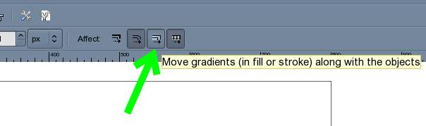

After you create a gradient or a linear or radiale.Come you can lock the Gradation on the object to move?
block gradient

Hi Alex,
Yes you can. Make sure this setting is on and the gradient will move with the object,

Re: block gradient
Hi!
thanks very nice
