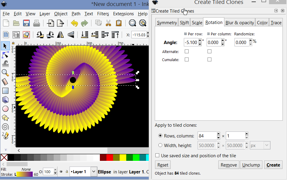

Im experimenting with tiled clones.
Here im rotating a gradient ring by 8% and scale it at the same time on the x-axis by 10%.
I discovered a really beautiful effect once i reversed the z-order with the Restack extension.
Now im wondering: is there a way to get this reversed z-order directly through the tiled clones dialogue ?

did you try starting with the large one and reversing the scale (90.91%) and making the rotation negative (maybe not necessary unless you want exactly the same)

druban wrote:did you try starting with the large one and reversing the scale (90.91%) and making the rotation negative (maybe not necessary unless you want exactly the same)
Dear Druban,
this doesnt work.
I dont want to re-engineer what i got, i need to reverse the z-order with the tiled clones dialogue, so i can explore the beautiful effects directly.
Is this possible ?

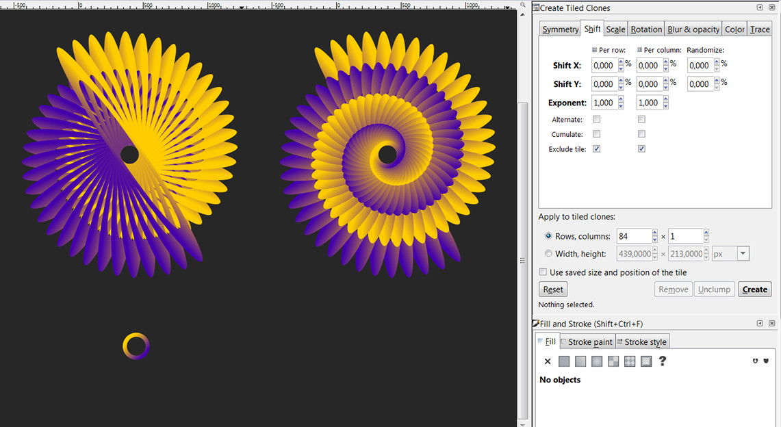

I think Druban means this:
This generates without restack. If you don't care for anticlockwise rotation, you can flip them all afterwards.
Re: tiled clones and z-order
If you are trying to get each new clone to go under the last one there is no way to do that. Inkscape always creates new objects on top of older objects. If you want to just "play" within the TC dialog to see what you get and want that option it is not available within that dialog.
