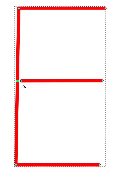

Hello. I am running into this issue as well. In the thread, I noticed that it was mentioned that the two nodes to be joined have to be end nodes. I need to join an end node and a middle node. I am trying to form an E. Is there not a way around that? I can't use text because I do not have a font that looks like what I want.
Inkscape 0.91 on a Windows 7 Pro 64 bit computer

Re: Design Change: Joining Nodes
Unfortunately there's no way to join two nodes in the way you want - the SVG format simply doesn't allow for it. You can, however, use snapping to get your two nodes to be co-located. If you subsequently try to move one, the other won't go with it, but you may be able to get round that by "rubber band" selecting both nodes before moving them, so that you're actually moving both at once, rather than just one of them.
Xav wrote:Unfortunately there's no way to join two nodes in the way you want - the SVG format simply doesn't allow for it. You can, however, use snapping to get your two nodes to be co-located. If you subsequently try to move one, the other won't go with it, but you may be able to get round that by "rubber band" selecting both nodes before moving them, so that you're actually moving both at once, rather than just one of them.
Thank you.
